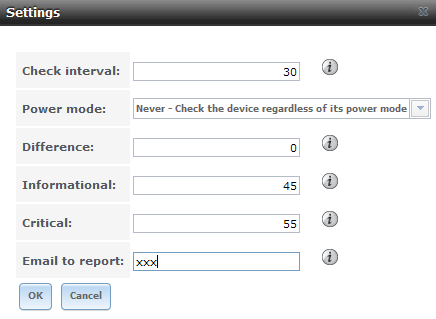

I didn't change the SMART settings
does not really explain anything
