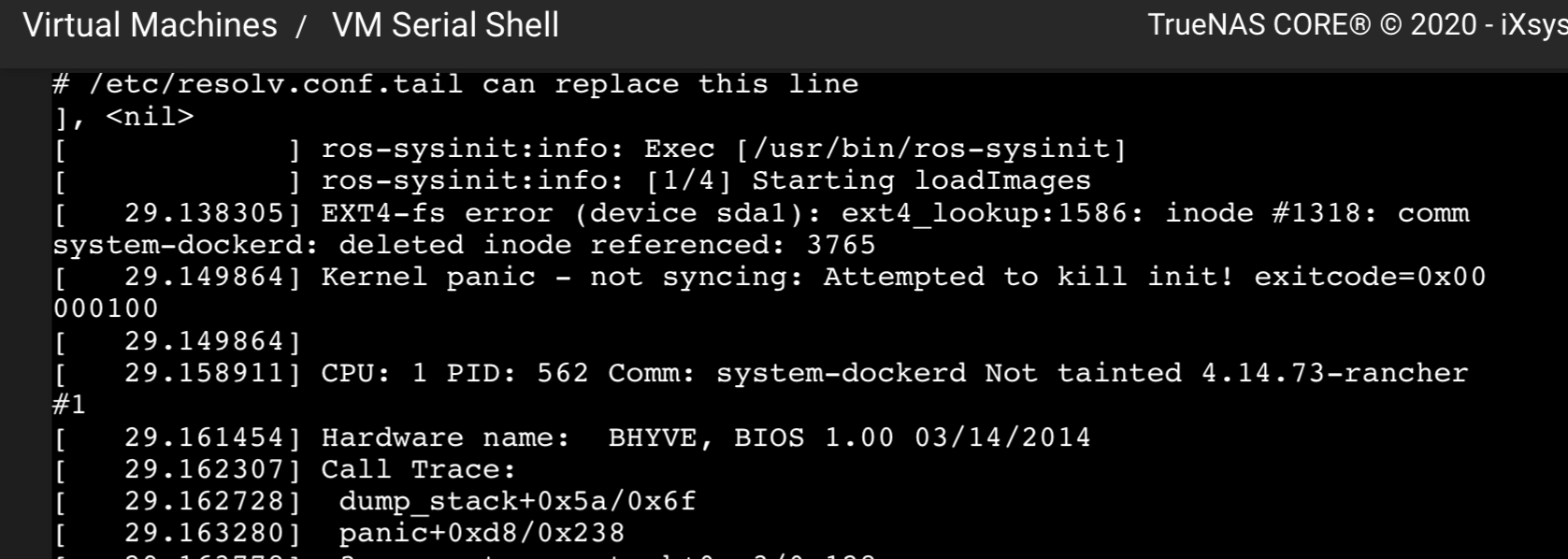

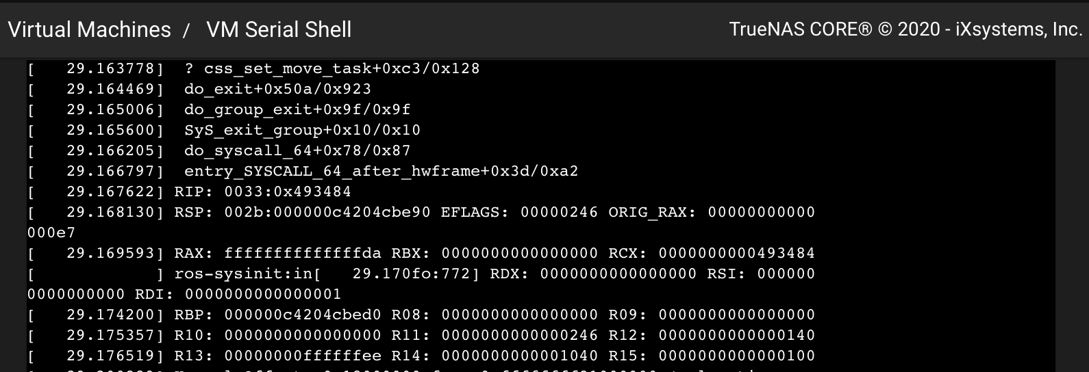

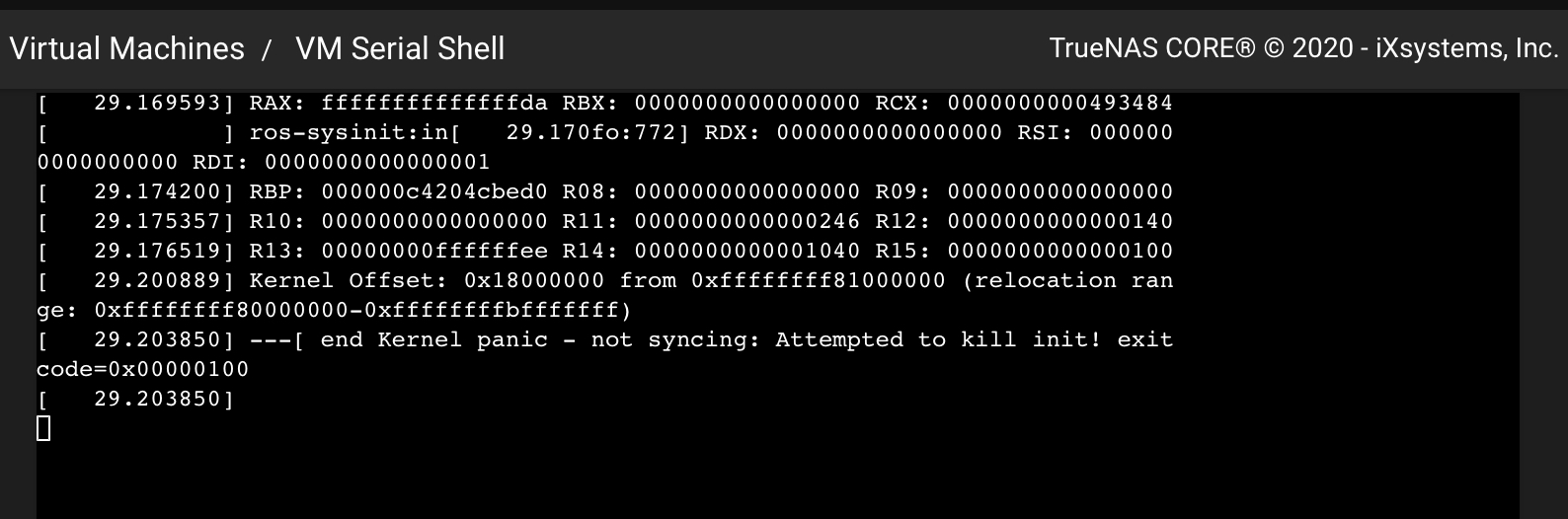

I followed them and changed the interface ip to the old one but i'm getting those errors while booting the VM .. is there something i'm missing ?!!

Ouch. The RancherOS boot disk has a corrupt ext4 file system. Try booting back into recovery mode, and then try to fsck the ext4 partition. If fsck can't fix it, then you can only delete and rebuild the VM from scratch. Of course, this means reinstalling all your containers from scratch again.
