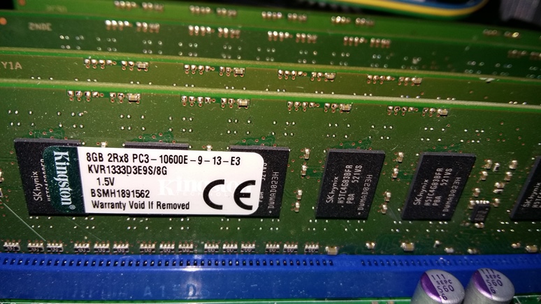

KVR1333D3E9S/8G Doesn't work in 32GB setups on the X9SCL (Or X10 series it appears).. Always pick DIMMs listed on the approved SuperMicro memory list (for your appropriate configuration)..
Yatti420
Aug 12, 2012
1,437
I have two pairs of KVR1333D3E9S/8G that will not under any configuration allow for 32gb (just the 5 beep - memory error no post).. Must be the underlying chip on the dimm or something.. I believe they are varying hynix chips.. Looks like these boards have the same stubbornness as the x10...

No worries.. I think I read Kingston DIMMs.. Elipida chips were tested QVL.. Either of the sets (Kingston - Various Hynix?) I have work for 16gb no problem..

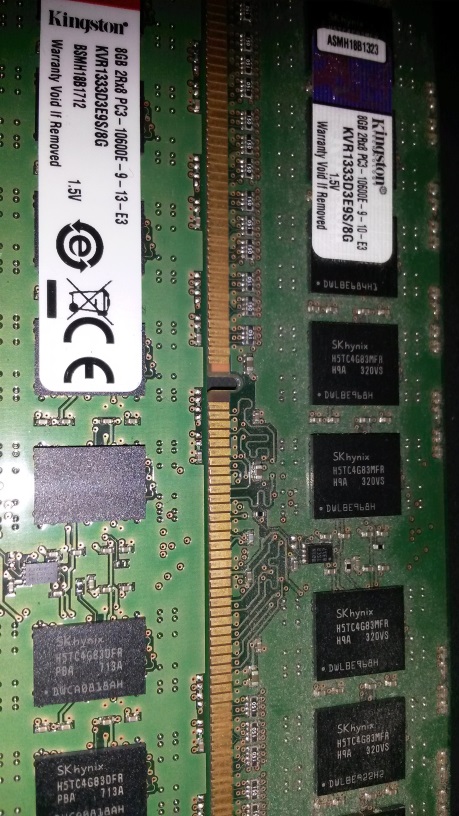

May 10, 2017
838
Can you check what chips are used on the DIMM?
They are Hynix:
Yatti420
Aug 12, 2012
1,437
I have two varying versions of a hynix chip.. They are close but are different (even the modules slightly) I read to reseat the cpu.. Or find a matching set of sticks.. Other then that I'm at a loss.. Either set work in the blue slots.. It's those pesky black slots.. I'll get everything done will waiting on a new PSU..
Yatti420
Aug 12, 2012
1,437
Well that's just stupid.. with my luck i expect it to fail lol.. new psu was well warranted.. or the reseating of the cpu did the trick.. 32gb should be working with both pairs of dimms now.. it's no longer giving post beeps..
Sent from my SGH-I257M using Tapatalk
