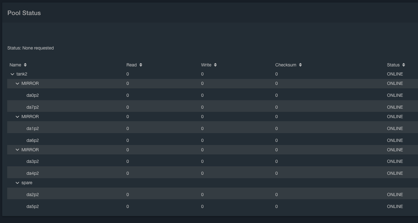

kazix
Jun 17, 2019
18
ok, i just test my configuration.
8 Disk SAS (each as RAID 0 on Hardware RAID) give me almost 900 GB and two Spare. (Mirror)
Theoretically (on different hardware) - this will be a good solution?
RaidZ2 with one Spare give me almost 1,3 TB. (RaidZ2)
When i can't use FreeNAS i see how much i love it. :mad:

Oct 18, 2018
969
No, this is not a good solution. As was mentioned previously, do not mix hardware RAID with FreeNAS or zfs at all. Ideally you would just plug your drives straight into your motherboard or get an HBA flashed to IT mode and plug them straight into that. Turn off hardware RAID functionality.
kazix
Jun 17, 2019
18
@PhiloEpisteme i know that, im just testing - what i can say, it works.
like @HoneyBadger said - im looking something else, but why not testing?
BTW i ask about logical disk, if i have connect this 8 disk to controller without RAID.
This scenario: 3 x Mirror + 2 Spare is good?
