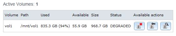

Built a simple RAID1 with two 1Tb drives, Seagate and a WD. Created the volume and shared it out. Copied a ton of stuff onto the volume from my pc, and it's been stuck in DEGRADED since. The second drive (Seagate) had the option to "Replace" which I did. Is it stuck in sync atm?
Ran fsck and it all checked out ok.
I've searched around quite a bit and can't find more info on why this is happening.

I'm using UFS. Volume reported COMPLETE after leaving it overnight, but now it's saying DEGRADED again. Console is spewing the following:
Aug 21 11:48:55 nasbox1 smartd[1266]: Device: /dev/ada1, 44 Currently unreadable (pending) sectors
Aug 21 11:48:55 nasbox1 smartd[1266]: Device: /dev/ada1, 44 Offline uncorrectable sectors
Aug 21 12:10:17 nasbox1 ntpd[1441]: time reset +0.192032 s
Aug 21 12:18:56 nasbox1 smartd[1266]: Device: /dev/ada1, 45 Currently unreadable (pending) sectors (changed +1)
Aug 21 12:18:56 nasbox1 smartd[1266]: Device: /dev/ada1, 45 Offline uncorrectable sectors (changed +1)
Aug 21 12:48:55 nasbox1 smartd[1266]: Device: /dev/ada1, 45 Currently unreadable (pending) sectors
Aug 21 12:48:55 nasbox1 smartd[1266]: Device: /dev/ada1, 45 Offline uncorrectable sectors
Aug 21 13:10:38 nasbox1 ntpd[1441]: time reset -0.128771 s
Aug 21 13:18:55 nasbox1 smartd[1266]: Device: /dev/ada1, 46 Currently unreadable (pending) sectors (changed +1)
Aug 21 13:18:55 nasbox1 smartd[1266]: Device: /dev/ada1, 46 Offline uncorrectable sectors (changed +1)
Aug 21 13:48:56 nasbox1 smartd[1266]: Device: /dev/ada1, 46 Currently unreadable (pending) sectors
Aug 21 13:48:56 nasbox1 smartd[1266]: Device: /dev/ada1, 46 Offline uncorrectable sectors
Aug 21 14:18:55 nasbox1 smartd[1266]: Device: /dev/ada1, 47 Currently unreadable (pending) sectors (changed +1)
Aug 21 14:18:55 nasbox1 smartd[1266]: Device: /dev/ada1, 47 Offline uncorrectable sectors (changed +1)
Aug 21 14:48:56 nasbox1 smartd[1266]: Device: /dev/ada1, 47 Currently unreadable (pending) sectors
Aug 21 14:48:56 nasbox1 smartd[1266]: Device: /dev/ada1, 47 Offline uncorrectable sectors
Aug 21 15:18:55 nasbox1 smartd[1266]: Device: /dev/ada1, 47 Currently unreadable (pending) sectors
Aug 21 15:18:55 nasbox1 smartd[1266]: Device: /dev/ada1, 47 Offline uncorrectable sectors
Aug 21 15:48:55 nasbox1 smartd[1266]: Device: /dev/ada1, 47 Currently unreadable (pending) sectors
Aug 21 15:48:55 nasbox1 smartd[1266]: Device: /dev/ada1, 47 Offline uncorrectable sectors
Aug 21 16:18:55 nasbox1 smartd[1266]: Device: /dev/ada1, 47 Currently unreadable (pending) sectors
Aug 21 16:18:55 nasbox1 smartd[1266]: Device: /dev/ada1, 47 Offline uncorrectable sectors
Aug 21 16:48:55 nasbox1 smartd[1266]: Device: /dev/ada1, 48 Currently unreadable (pending) sectors (changed +1)
Aug 21 16:48:55 nasbox1 smartd[1266]: Device: /dev/ada1, 48 Offline uncorrectable sectors (changed +1)
Aug 21 17:17:15 nasbox1 cnid_dbd[20127]: Set syslog logging to level: LOG_NOTE
Aug 21 17:18:56 nasbox1 smartd[1266]: Device: /dev/ada1, 48 Currently unreadable (pending) sectors
Aug 21 17:18:56 nasbox1 smartd[1266]: Device: /dev/ada1, 48 Offline uncorrectable sectors
Aug 21 17:48:55 nasbox1 smartd[1266]: Device: /dev/ada1, 48 Currently unreadable (pending) sectors
Aug 21 17:48:55 nasbox1 smartd[1266]: Device: /dev/ada1, 48 Offline uncorrectable sectors
Going to pull the drive, and replace it with another on to see if the issue goes away. Perhaps the drive is just busted.
This is a good point, the DEGRADED status doesn't disappear immediately, it takes time to re-syncronize (resilver) the disks and during that time it will still show DEGRADED.
@jack.tremaine - It definitely looks like you have some kind of hardware failure. Most disks these days are such junk I barely trust any of them, that's why I have a raidz2, but even then I'm nervous.
