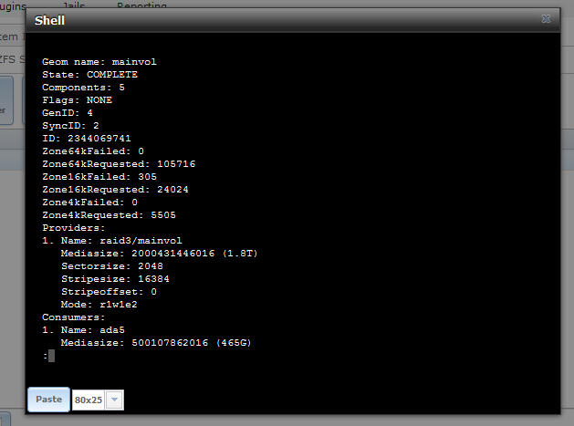

ausmike
Jan 18, 2015
6

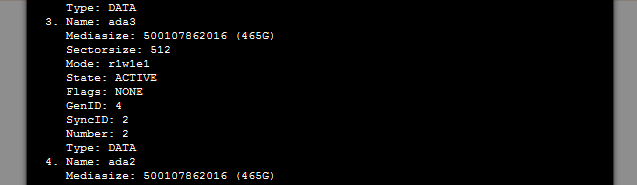

Firstly, you need the name of the volume and you need to know which drive number ada3 is.
To do this, start a shell and type in "graid3 list | less"
In my case, the volume is called mainvol. Use Ctrl V to page down till you see ada3
Note the number for it. In my case, its 2 (press Q to exit from the "less" STDOUT viewer)
Once you have those two bits of info, in my case, the remove command becomes
graide3 remove -n 2 mainvol
you would need to replace the 2 with your drive number and the mainvol with your volume name.
After putting the new drive in, in my case, the insert command is
graid3 insert -n 2 mainvol ada3
Again, you would need to replace the 2 with your drive number and the mainvol with your volume name. Once this is done type in
"graid3 status"
to see it rebuilding
