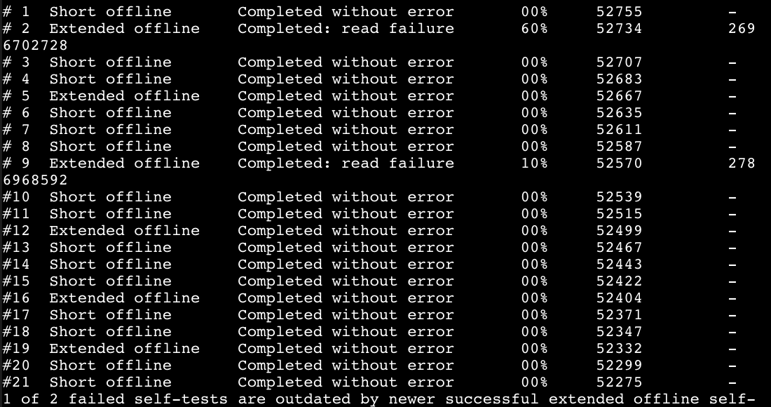

Hi everyone,
Not my first time I have had drives go bad... but it is the first time I have had 2 fault at the same time. Thankfully its a Z2 array, and I have a cold spare waiting to go in. But with 2 drives down, I am a little weary of how to approach this.
Would it make sense to do a zpool clear to force it to think everything is ok, and then replace one of the drives with my cold spare? See how the resilver goes, do a scrub, and monitor the situation? I don't want to get myself into a worse situation by jumping to any conclusions prematurly.
I have had a few SMART errors pop up over the past few SMART tests, I guess I didn't dig deep enough into them because I had thought the drives were still working fine (I have had eronious errors in the past that didn't actually result in bad drives or any corruption). Looking at the SMART status of da5 (Drive with 62 faults according to zpool status), I am seeing:
  1 Raw_Read_Error_Rate     0x002f   199   199   051    Pre-fail  Always       -       43
  3 Spin_Up_Time            0x0027   186   161   021    Pre-fail  Always       -       5700

What should my next steps here be?
To stave off any questison about hardware, it can all be found in my signature, but the controller is a H310 to a SAS expander, and has been in good working order for 7+ years (minus a few drive failures over the years). Its possible a SAS -> SATA cable (or two) is going bad, its happened to me before. But I am thinking this is not that sort of situation.

I added in my cold spare to attempt to replace da5, truenas hung... So I went to reboot it, it hung some more. Eventually just shut it off via proxmox webUI, turned off the host, reseated the HBA, replugged cables etc.
During the shutdown, I saw this pop up on proxmox console for truenas:
At boot up after the reseat of the HBA and cables, I got this:
With the above errors being shown on console, I logged into truenas webui to see the pool as being online, ok, and in the middle of a resilver??? 72% done with a resilver to be precise. I was worried the above errors being thrown would be indicative of a bad HBA, so I turned off truenas via proxmox (if I have a bad controller, I really don't want it writting shit data across my entire pool... although if it really was 72% completed and that was the case, I am worried I may be SOL anyways?).
Not entirely usre what is happening here, but truenas is turned off until I can get some better understanding of what may be happening. Or maybe (hopefully) I am missunderstanding the above errors, and its simply reporting that da6 (whiever drive this ended up being on this reboot) is just really, really not happy about things and not actually a controller failure?

Well, assuming the Truenas GUI is not non-sensical, I am replacing the worst of the 2 drives with my cold spare now. It looks like it was already resilving the current worst drive (it is again listed as da6), so once that is finished it will start the replacement with the cold spare.
I am not sure why it is trying to resilver the currently bad drive since it was faulted out... I guess when i rebooted it earlier it threw it into a resilver function since the drive did come back online? Eitehr way, the pool is currently listed as online, no data errors across the pool itself, but the worst offending drive is showing 10 read errors currently.

Thanks for the advice, we shall see how this goes. New drive to replace the potentially second bad drive shows up tomorrow, assuming all is well and nothing is worse, I plan to badblocks is as I normally do prior to deploying a drive, and then repeat this process. If the second suspected bad drive starts to yeet isetlf from the array, I may forgo badblocks as I think I would rather a likely working new drive vs a known bad drive in my array, we will see...

Thanks for the info. All seems to be restored to health. The bad disc did end up falling out of the array again during the resilver, too many errors were seend and ZFS faulted it out. But the cold spare was resilvered, and the pool is once again fully healthy.
I did have 2 faulted drives yesterday, but after the reboot one of them was onlined and has remained online through the resilver process - that said, I have a new drive being delivered today that I plan to swap it out with. The known bad drive I will take in to be recycled, but the second drive that is currently working fine, I am wondering if it in fact was able to reallocate some sectors and is now "happily" going about its life. Once I swap the drive out for a new one, I will bad blocks it a few times and see if the SMART results change. If not... I will hold onto it as a marginally trust worthy cold spare I suppose.
No. The SMART self-test is completely internal to the drive. If a SMART Long/Extended test fails, then the drive should be replaced, which is what you are doing.
Wow, over 52,700 hours (over 6 years), that is a long time.
