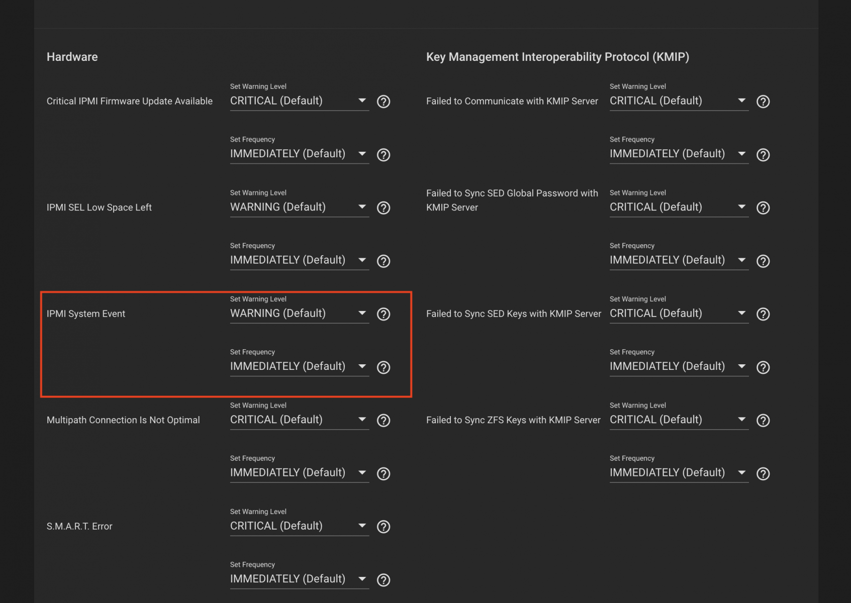

9,703
My guess is that it's coming from here:
System | Alert Settings...
fivade
Mar 9, 2021
7
didn't realise it would be under ipmi system event when i first looked at that page myself. is there a way to configure the email template used by those alerts, to perhaps include device name ?
