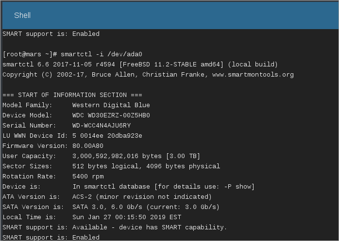

What is the smart data output for the drives?
smartctl -i /dev/sdc
where sdc is drive designation.
I have had drives pass the drive utility but not FreeNAS. The utility allowed "problems" if they are inside the fault tolerances. FreeNAS doesn't allow any errors without alerting you.

I just noticed that this drive is 5400rpm while the Seagates are 7200rpm. Which would also explain why 1 Seagate showed errors when I had 2 WDDs running. Do you think that is why? If so, any way to get FreeNAS to support/handle this or should I just buy another drive so I have 3 identical ones at all times?

Having mixed matched drive speeds should cause errors that I'm away of. I have one 7200RPM drive in a pool with 5400RPM drives and haven't seen any problems in the last two months. I didn't have an extra 5400RPM drive laying around when I had a drive error. It looks like smart is available for this controller..
Could you run
 smartctl -a /dev/ada0

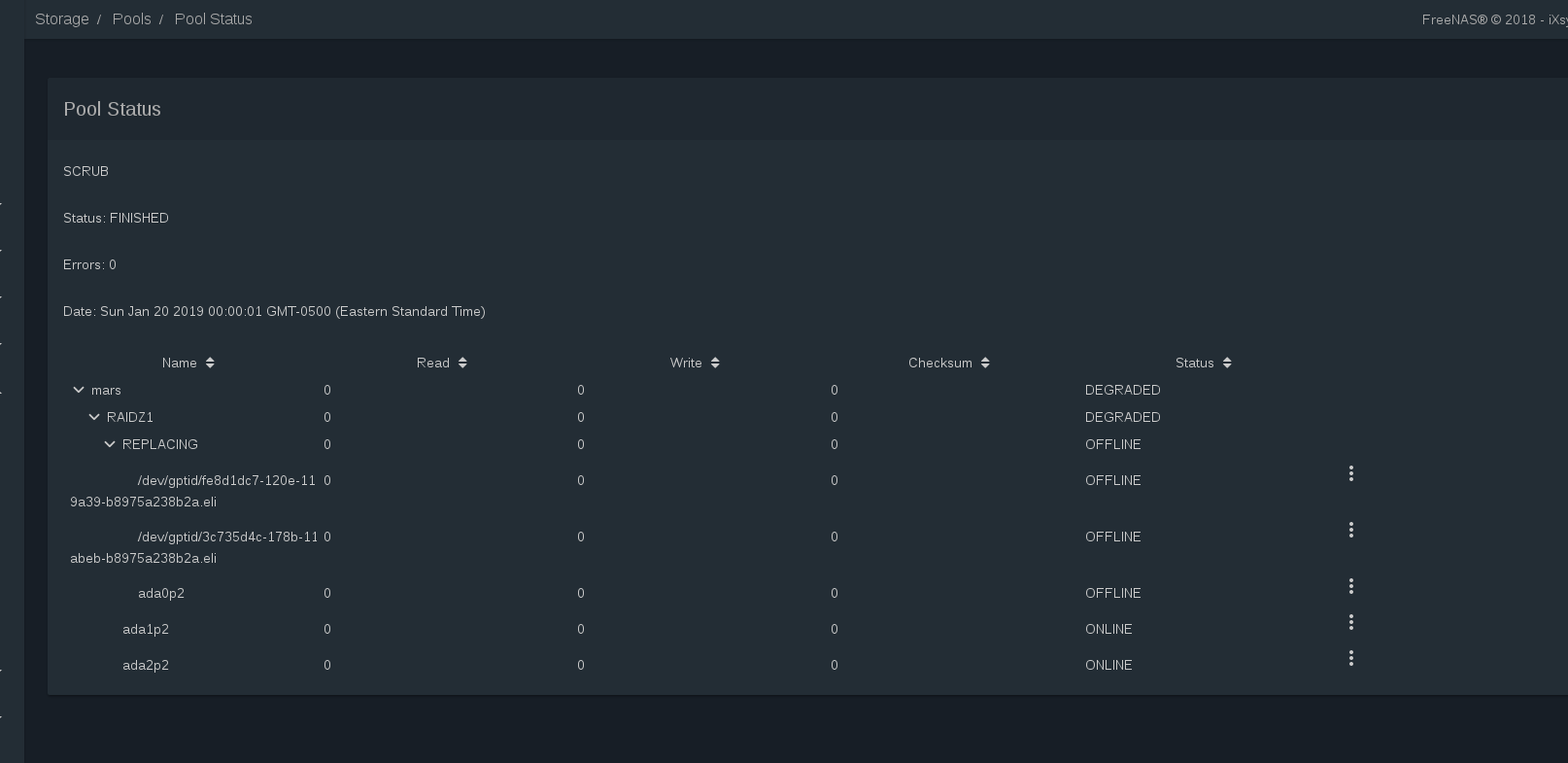

I cleared it already...and did a bunch of disk swapping/testing so not sure if I can get the most recent. I will be glad to re-silver and force it back though if that would be best. I always end up with this as an end result:

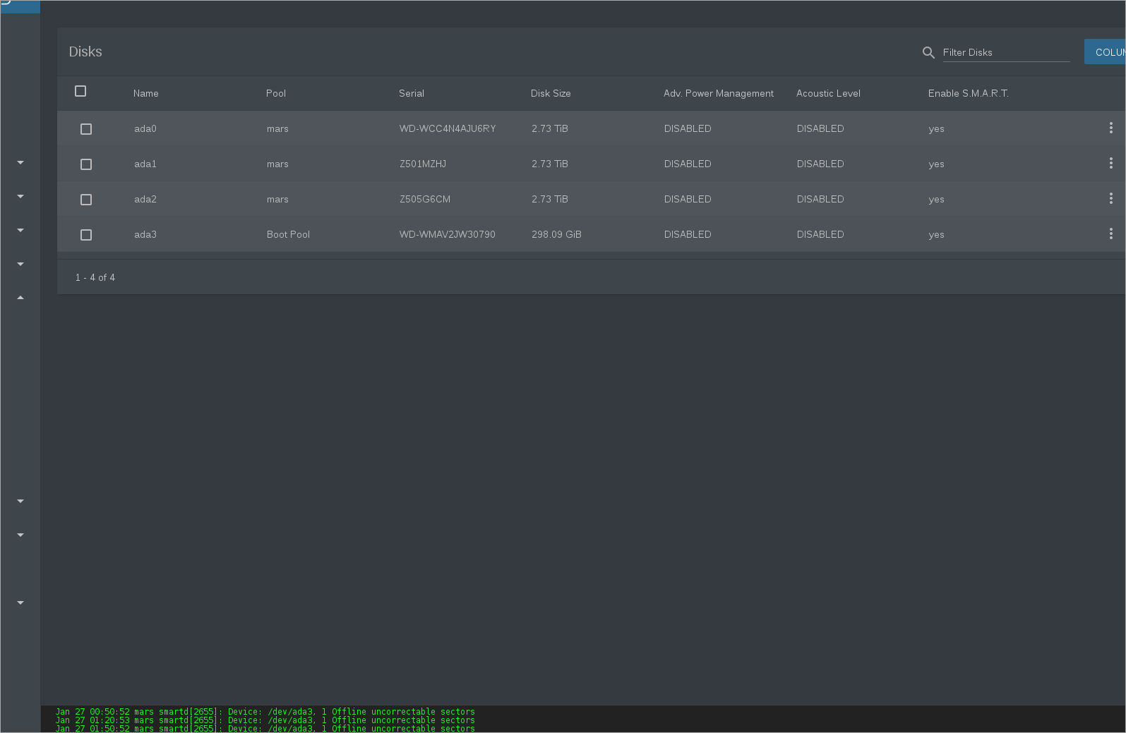

I just found an error for ada3 as well...and that is my boot drive. Not sure what is going on at this point...
While the errors being flaged by the console are an issue to be rectified they pose no immediate threat to your array as this is just the boot device. I had a disk that liked to do this when i was using an old fashion raid card. when i switched to freenas i replaced the disk and it solved the issue.

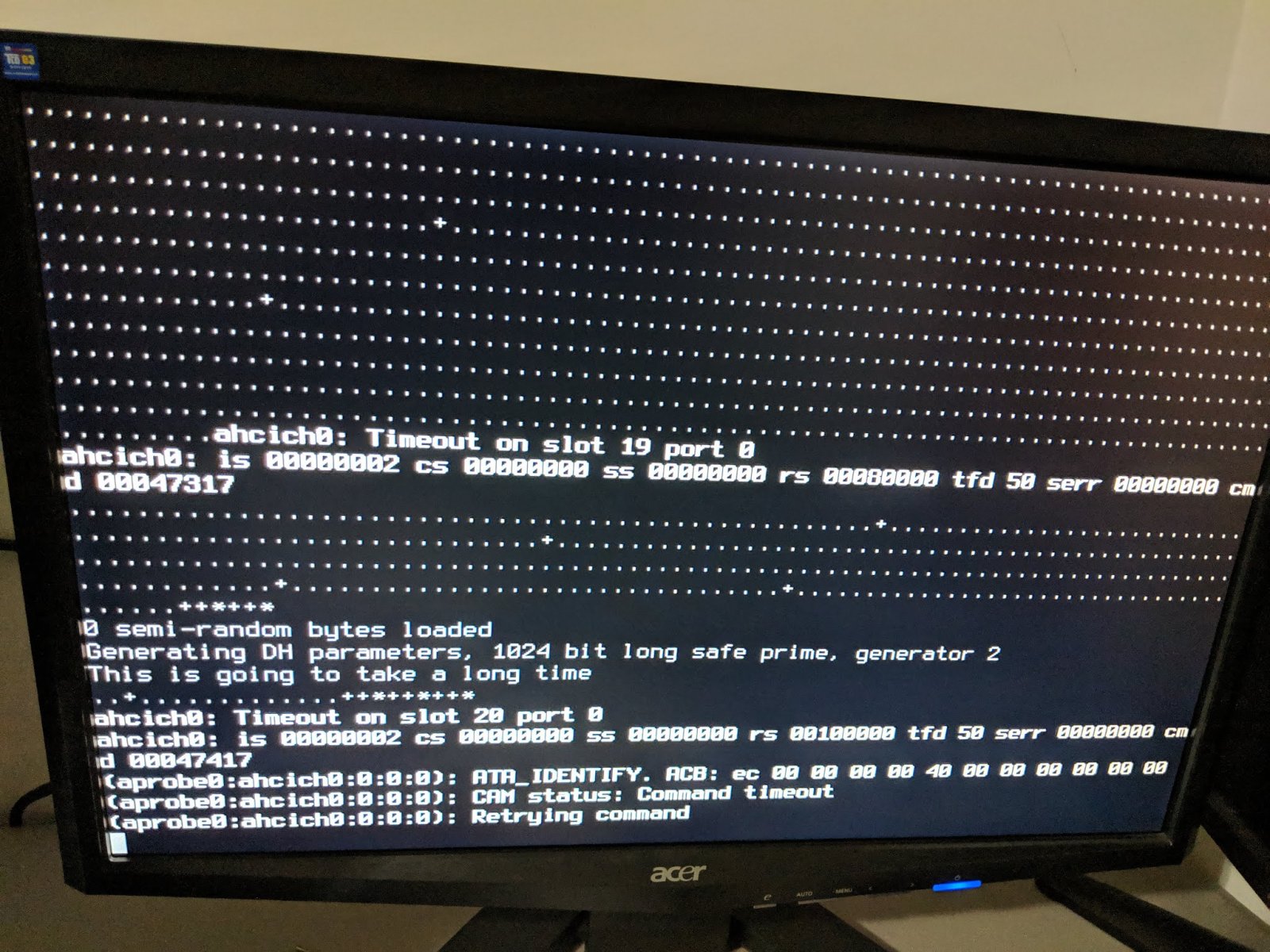

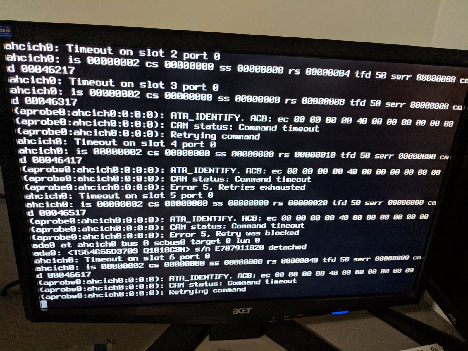

Bought a new Seagate and the SSD. After installing the latest and greatest version of FreeNAS and booting up, I get this (below). Seems like the mobo is at fault after all??? I have another "server" laying around, but of course it doesnt have 4 SATA power ports so I will have to get an adapter for the old school 4 pin cables, or swap that out I guess. Let me know if this confirms my board should be taken to the shooting range.
It has been sitting at that screen (but keeps retrying) for the past hour.

Make sure the SATA controller is set to AHCI and not IDE in the BIOS. Also, when installing FreeNAS be sure to have all other drives detached.
Logikgear
Feb 22, 2016
43
Looking at the manual PDF, Once your in the BIOS.
It should like like this
Chipset > SouthBridge Configuration >
OnChip SATA Channel [Enabled]
OnChip SATA Type [AHCI]
Then try and install again.
