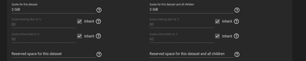

I have a dataset with no children that I want to set some quotas on, so for this purpose I have set the quota to 3GB. However, to my surprise when I try to extrapolate the quota by creating a file I see that the quota is not enforced and I can create files sizes with several times beyond what's defined, just as if having a quota configured or not makes no difference.
This is the quota definition of my dataset:
