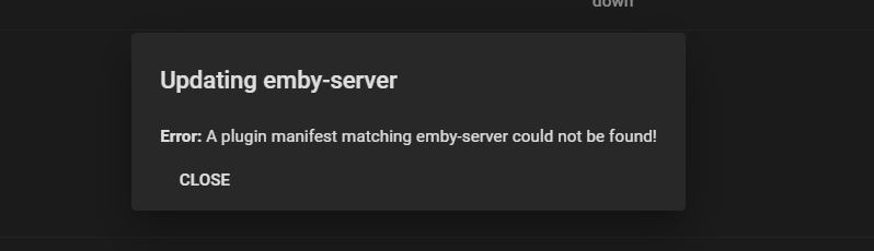

Just an FYI - I tried to update the existing jails from 12.3 RELEASE-p5 to 12.4-RELEASE-p3 using the update function within the Jail, but I got the attached error. I'm wondering if should use the shell command to perform the update, but then came across this thread - https://www.truenas.com/community/threads/update-freenas-version-of-emby-jail.83296/. Would you know if the resolution by nadinio works? I guess I'll try it and I'll find out.

I planned on building a new NAS anyway, so what I did was installed Core 13 on the new NAS and then pulled the drives from the old NAS and imported the pool to the new NAS. That pool contains my Emby server that was created on 12 and is still on 12. So TrueNAS is 13, but Emby Jail is based on 12. If I try to update the Jail to 13, I get an error. So what I did was I created a new Emby server based off of 13 and duplicated the two. One based on 12 and the new one based on 13. I plan on getting the one based on 13 perfect and then I'll back it up. I'm hoping I can create a third Emby server, this one being based on 13. Then I'll use the backup to make it a duplicate of the other one based on 13. Then I'll delete the one based on 12. I know there is no need for two duplicate Emby servers, but I like to have one as a "backup" of sorts.
