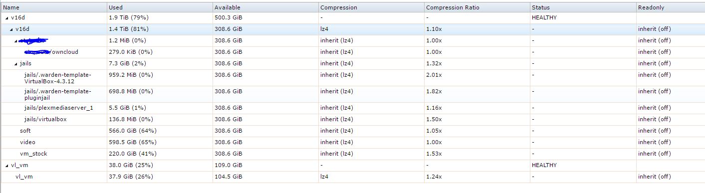

hello
i have a question about the size my pool (1.9TiB) and my dataset only 1.4TiB
why this difference of 192GiB
tank's
depasseg
FreeNAS Replicant
Sep 16, 2014
2,874
Parity and possibly snapshots.

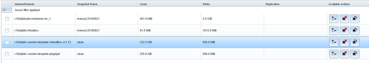

snapshot i thick no
but parity maybe but i dont understand something
i have 16x149GiB driver in raidz3 this give me a 2.38TiB pool minus 3 drives total 1.9Tib size of my volume all is ok
i create a dataset and then the size is now only 1.7Tib
where are this 200GiB
my question was incomplete, thank's for you fast reply :)
depasseg
FreeNAS Replicant
Sep 16, 2014
2,874
the first line is the raw size
the second line is the size after parity and file system structure.
Are you sure your disks are 149GiB, or are they 149GB? There is a ~10% difference between those terms.

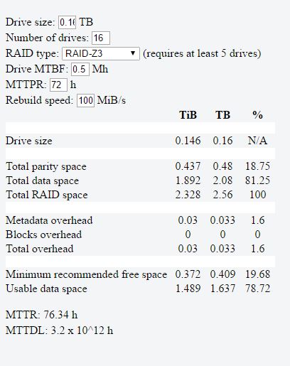

i enter 0.160GB
result in picture 1.892 TiB but I have 1.7

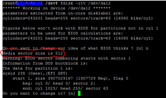

and is it a command to check what drive is native a 4k or 512b ?
EDIT:
i found a command : fdisk -itv /dev/da12 answers no at the first question and report the sector size
all of my drive show 512b ...
after i found a list of 4096b drives but all have physically 4096b but logically 512b
https://wiki.archlinux.org/index.php/Advanced_Format
then if most of drives are logically 512b why freenas set a default ashift to 12 and not 9 ?
is my controller and or back plane not 4096b compatible ,Supermicro BPN-SAS-836EL1 16 Hotswap, LSI sas 9211-8i 6 Gbits/s 8 ports sas ?
many question !!!!

Bidule0hm
Server Electronics Sorcerer
Aug 5, 2013
3,710
Actually there's no real harm (no lost space, maybe a little bit of perfs loss) to use 4 kB blocks on 512 B sectors drives.
It's the physical value that matters here. The logical 512 B is only for compatibility.
What are the models of your drives?
