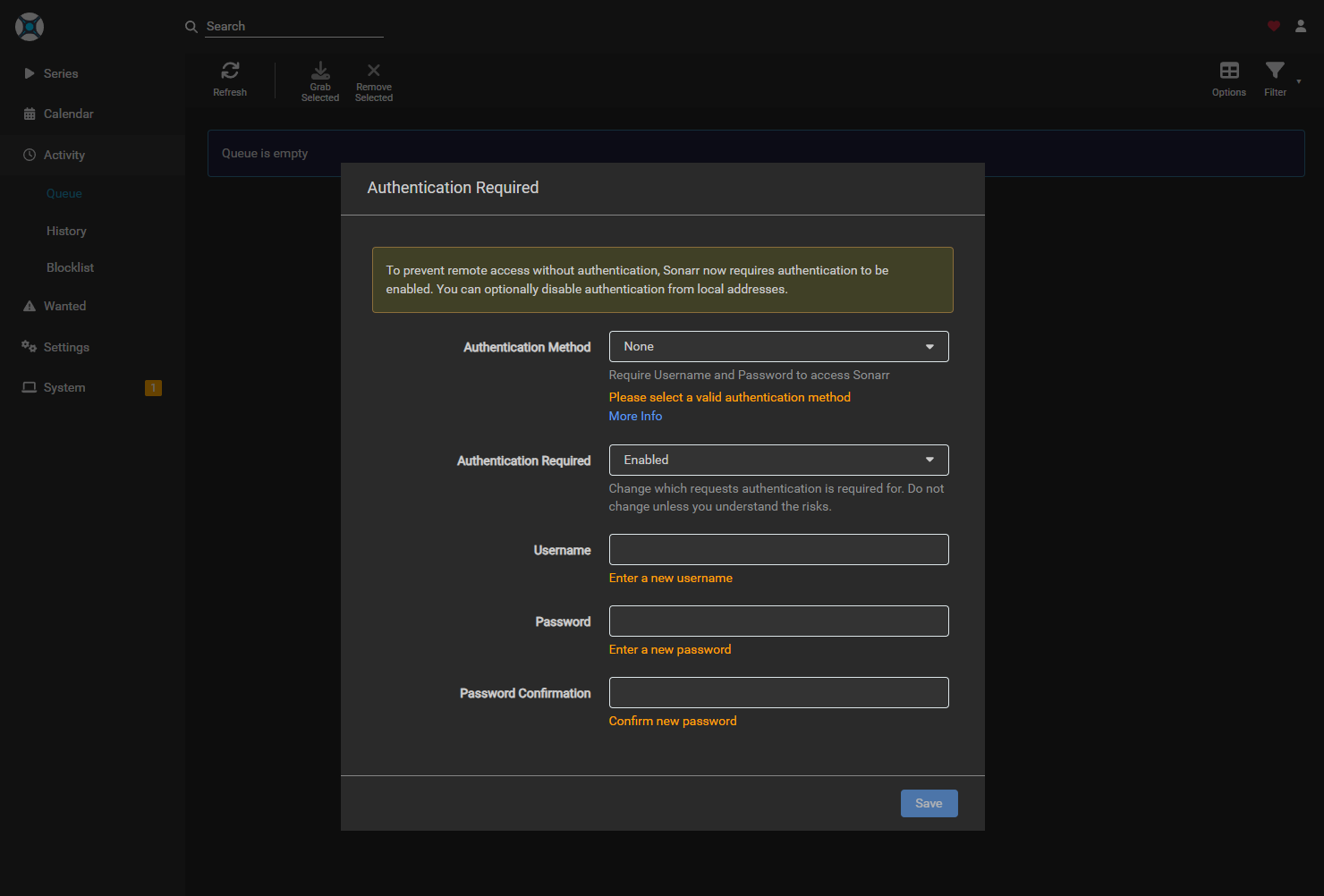

To get past the forced login I had to edit /usr/local/sonarr/config.xml
<AuthenticationMethod>Basic</AuthenticationMethod>
<AuthenticationRequired>DisabledForLocalAddresses</AuthenticationRequired>
9,703
I was able to set that in the GUI after the first login following the upgrade... not sure on the settings that made it necessary for you to edit that way, but good to know in case.

Thanks for the post helped me get things working. Specifically all I had to do was set mlock for my jail. Everything else just works and upon loading up the webpage for the first time I was prompted for the authentication setup.
