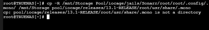

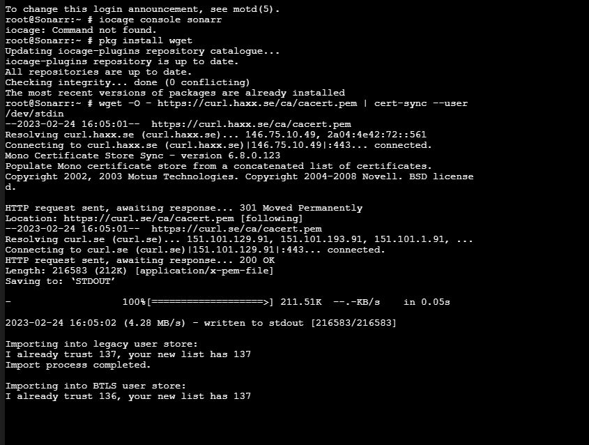

I have tried what you have done here, made sure my pool name was the same and made sure the jail was spelled correctly and case sensitive and all but I still get "no such directory exists". I know im not very smart when it comes to this stuff but I think I can change the name of my storage pool and what not.
Any idea what might be causing the issue?

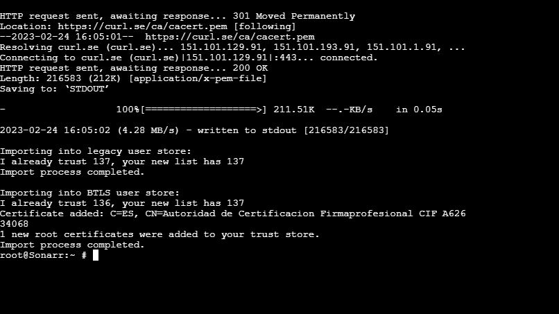

I'll need a bigger picture to be able to tell. Can you run the commands (Frog's original and the edited one Mohkhasa figured out) again and paste a screen shot or copy/paste the text. That plus your data like your storage pool name, jail name, and release number

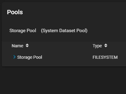

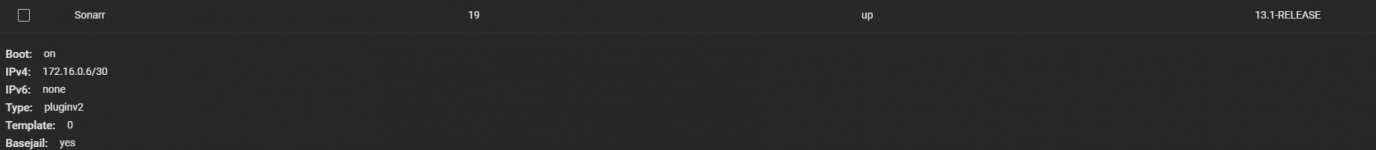

I have attached the images, Lidarr and Radarr seem to work find but Sonarr is the one giving me problems. I know the first command "iocage" said it is not a command so maybe im not doing that one correct.
Thanks for your help.

FWIW I also got that error for iocage on mine, but it ended up fine.
Okay, so if it's not finding the directory, let's find it the old fashioned way. Go to your TrueNAS shell, and 'cd' your way through it. CD to each step of the command, find the right directory names, and when you get there you'll have the full path command to use.
As you can see in my screenshots, I went through and I found the right folders, ending up with [/mnt/Pool0/iocage/releases/13.1-RELEASE/root/usr/share/.mono]. When you go through that maybe you'll find a directory that was a little off in your original command and you can just go change that.
One thing my old school IT brain is thinking is that typically shell commands haven't liked empty spaces. So your pool name being "Storage Pool" could be the culprit. If the file path commands don't find any oddities, I'd change your pool name. Even just putting an underscore instead of a space would fix that if it's the problem.
Let me know if either of those work!

ShameSpear, I really appreciate your help with all of this and it seems to be fixed now. I did end up changing the name of the pool to help with any future projects. I believe the space in the name was an issue.
After renaming the pool, reinstalling the ARR stack im using, everything seems to be working great. Getting Sonarr set up now.
Thanks again.

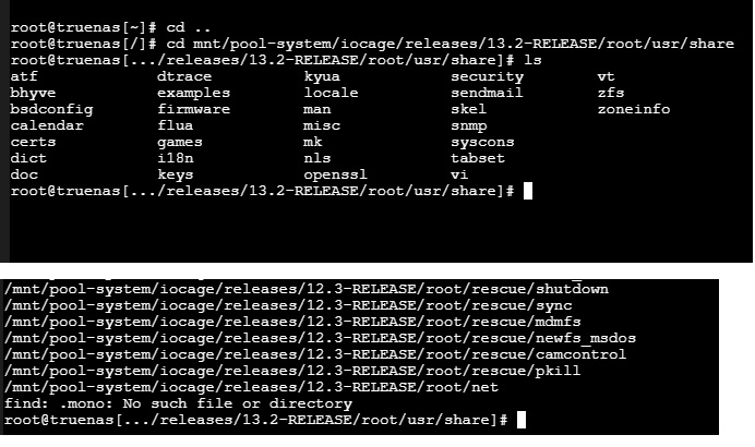

Apologies for resurrecting this thread but I'm a little stuck on this as none of my Releases (of which I have 12.3 though to 13.2) appear to contain a ".mono" directory in them (I've also searched for the "certs" directory too
Any thoughts on what I might be missing?

HughT, it is odd to me that it's missing, but the folder not existing in that directory doesn't really matter at the end of the day. The reason we have to do this whole thing is because that folder doesn't even have the correct data! As long as your Sonaar path ( /mnt/<StoragePoolName>/iocage/jails/sonarr/root/root/.config/.mono/ ]) has the mono folder, you can just create the .mono folder in your RELEASE folder path and copy over the data you need!
Hope that does it for you

Ah, that makes sense thank you for the explanation. I manually created the dir, copied across and it all works, many thanks!
