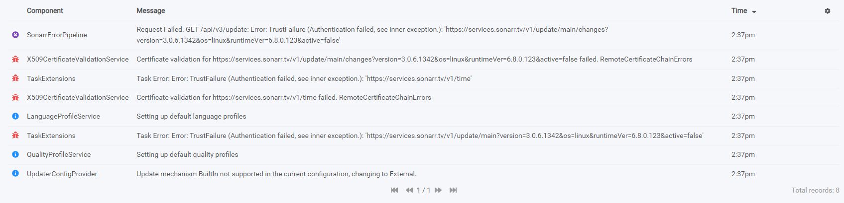

Sonarr/Radarr (probably other *arr) jails unable to verify SSL certificates after latest update

This is known issue with the FreeBSD's Mono 6.8 package that is missing it's root CA store, as the cert-sync and mozroots tools write to /usr/share (which is mounted as RO in jails) - https://bugs.freebsd.org/bugzilla/show_bug.cgi?id=258709
A quick fix for this is to copy the trusted root store from a jail after using cert-sync or mozroots for example:
iocage console sonarr
mozsync --import --sync
logout
cp -R /mnt/iocage/jails/sonarr/root/root/.config/.mono/* /mnt/iocage/releases/12.2-RELEASE/root/usr/share/.mono
I expect this is NOT a good fix, but it works around the issue in the interim; the bugzilla changes the path to usr/local/share, I am not
There was a similar thread opened and was incorrectly closed, hence a this thread.

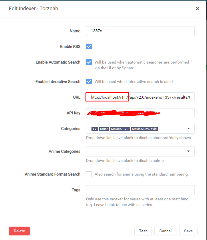

This also didnt work for me. Below is how I got it working.
I created a fresh Jail inside Truenas and called it Sonarr+Jackett with standard setting using DHCP.
I followed the following link to install Sonarr inside that jail:
https://www.digimoot.com/truenas-sonarr-v3/
Then i followed the following link to install Jakkett in the same jail:
https://www.digimoot.com/truenas-jackett-manual-install/
In my experience installing with the plugins dont work as great.
I also changed the link to localhost.
I hope this helps

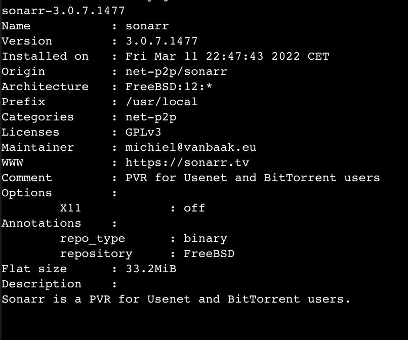

Jan 27, 2020
577
installing the pkg via the latest channel is working flawless for me.
pkg info sonarr:
