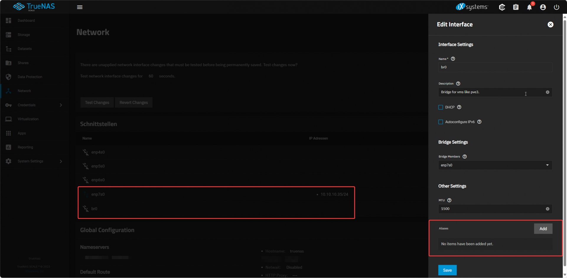

Thank you for the hint. I did something similar but based on a thread in another forum.
I can't set a alias for the br0 network. If i understand correctly, then the bridge should get the ip adress from enp7s0?
When i add 10.10.10.35/24 as an alias, i can not save the changes.
What am i doing wrong?
chuck32
Jan 14, 2023
623
Yes, effectively you remove the alias from enp7s0 and assign it to the bridge.
Did you follow the linked Ressource step by step? What exactly is the error message when it doesn't let you save the alias? I assume you did not remove the alias from your physical interface before.
I haven't reread the guide when I linked it, you have to assign the bridge to your VM when you are done.
Buddinski88
Aug 27, 2023
6
After my answer, the solution came to me. I did not remove the alias from enp7s0. This may only be assigned once and that should be br0. Now it works.
Thank you for the hint :smile:
