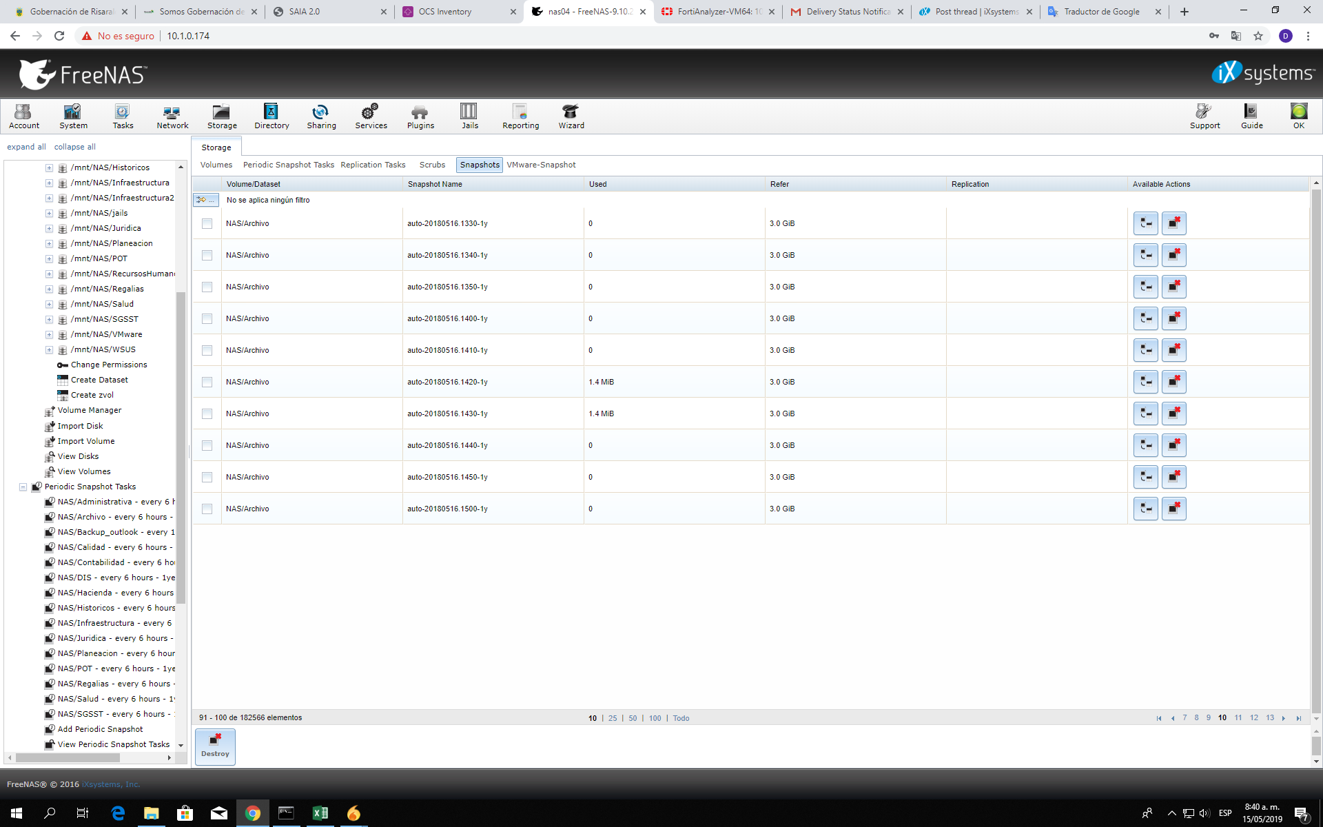

How about, I have a problem with my freenas, to which I have set several periodic tasks for the copies, but I see that these are not executed, I have them well configured, but I do not know what can be missing, or case it will be some problem with the software freenas?

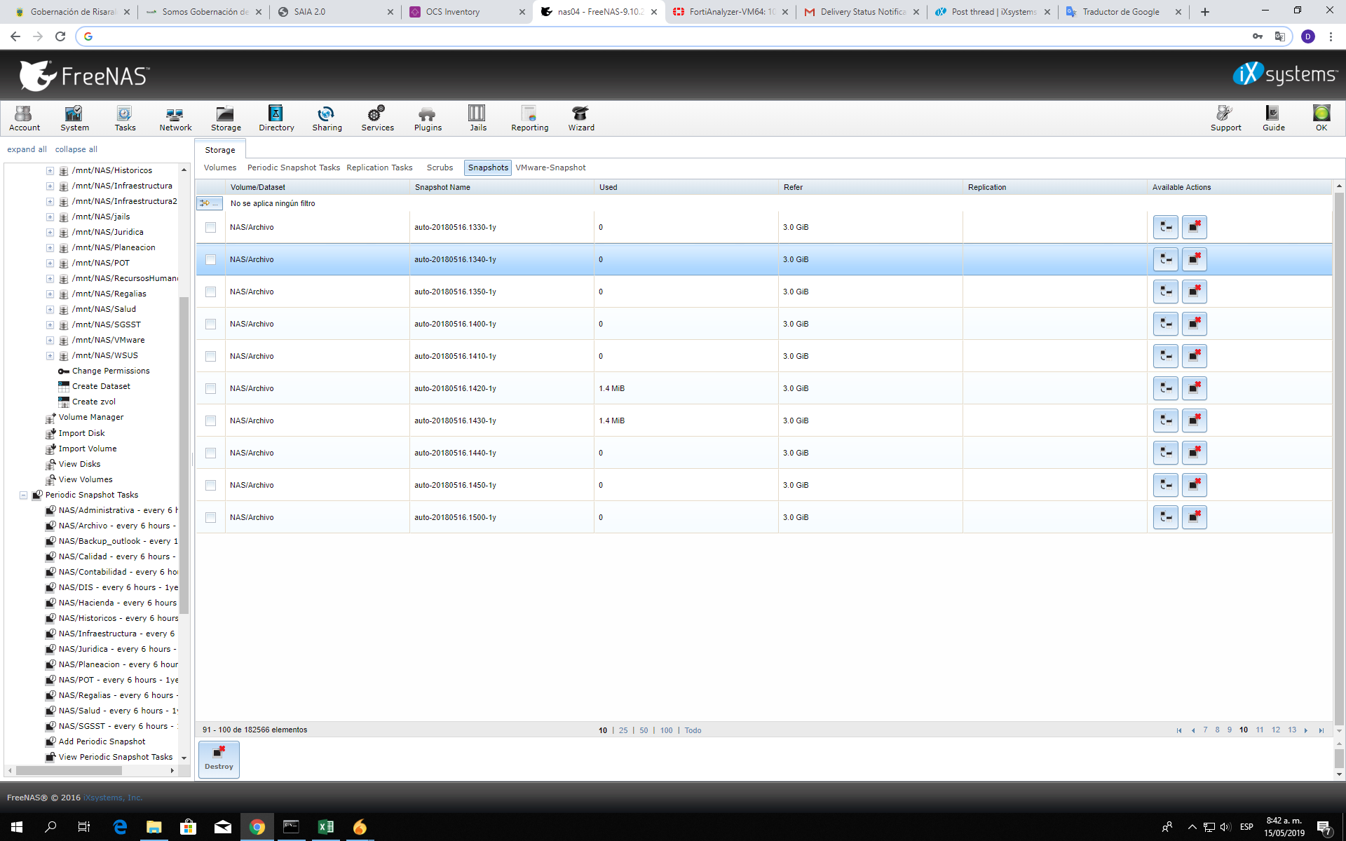

the snapshots in the screenshot appear to be from 2018? you are only seeing the oldest snapshots of 182,566 snaps. I think you need to look at the snaps that aren't a year old first.

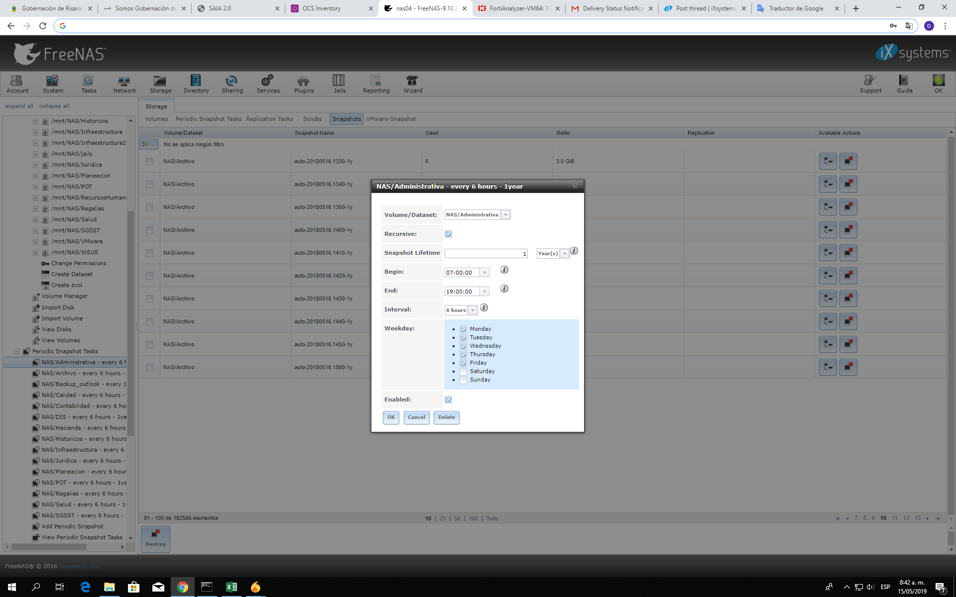

it looks like your configuration would result in 2 snapshot per day. 6 hour interval means 06:00, 12:00, 18:00, but you have the time limited to 07:00-19:00.
