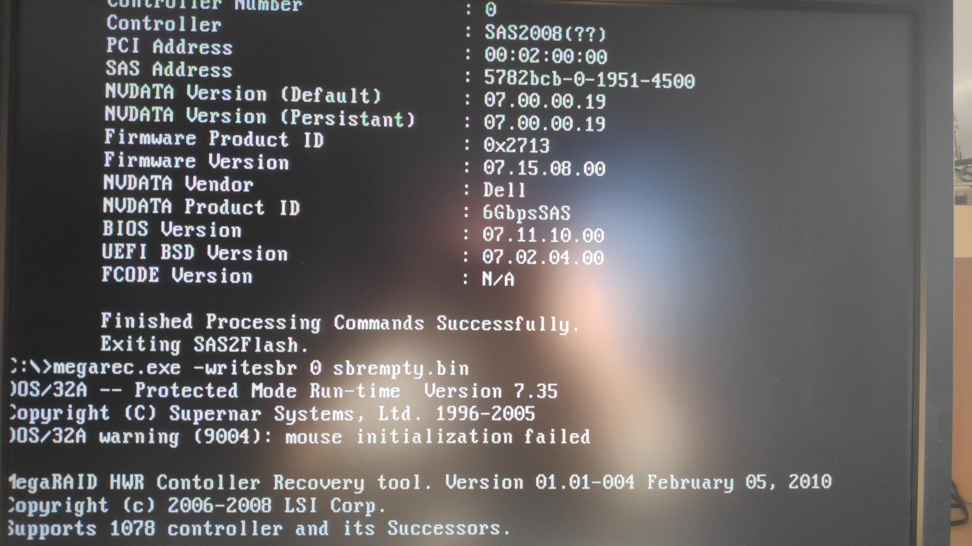

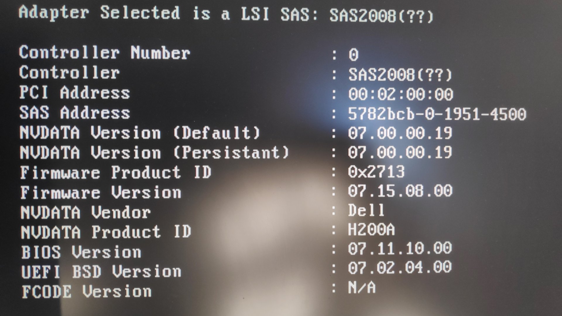

Hi, once I have made a copy of the data, I have followed the steps in the tutorial to convert the H200a into an LSI 9211-8i but I have had problems and now I think I have bricked the controller.
The command sas2flsh.exe -c 0 -list when executed returned the controller information, although in the version only questions appeared, SAS2008 (???) instead of SAS2008 (B2) as in the screenshot of the tutorial.
Running the command megarec.exe -writesbr 0 sbrempty.bin did not return any output and the cursor was blinking for more than 2 hours. In the end I ended up restarting the server and now when starting it indicates that it cannot load the firmware of the controller.
If I rerun the command sas2flsh.exe -listall it tells me that it finds an unsigned controller and asks me for the name of a firmware to load. I have instructed it to load the firm 6GBPSAS.FW and it returns that it has been flashed ok, but I can't follow the tutorial steps, any ideas?
Thank you very much for the help. a greeting

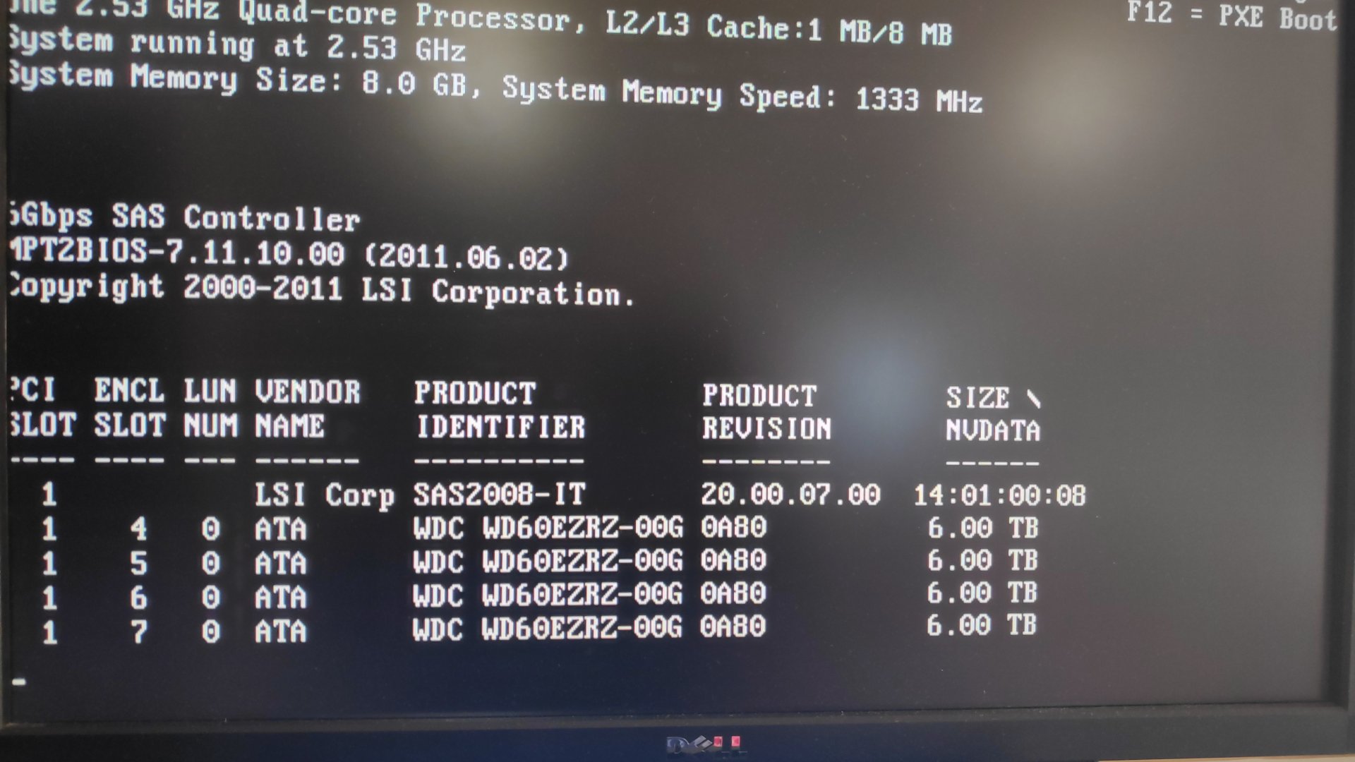

Finally, after several attempts, I have managed to install the 2118it.bin firmware.
I have started the server and I have seen that the disks are recognized by both the controller and TrueNas and it has allowed me to generate a pool of disks.

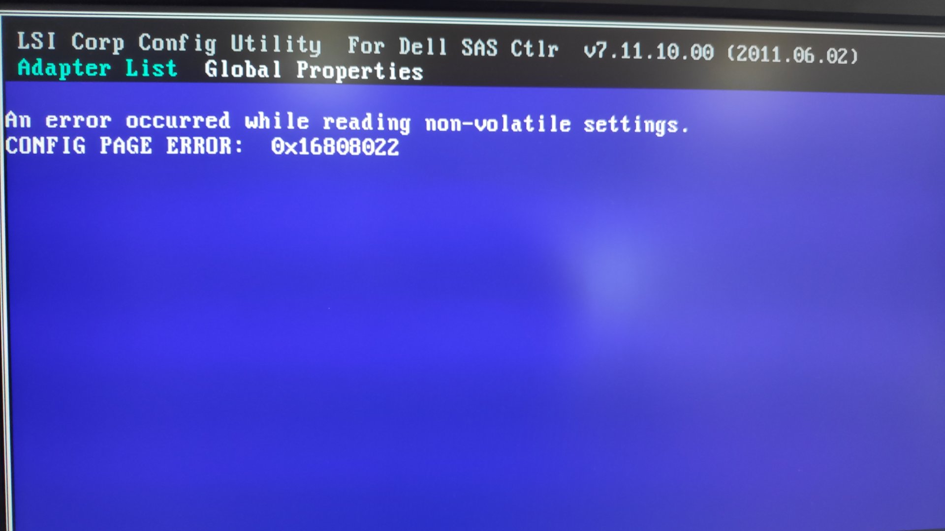

My doubt if there will be a problem is that if I enter the bios of the SAS controller it returns several reading errors of the non-volatile bios area. Is this error normal? Attached screenshot of the error (3 errors appear with different memory positions) as well as another capture in which it is seen that the card is flashed with the IT bios and the disks detected.
Thanks a lot. Cheers
