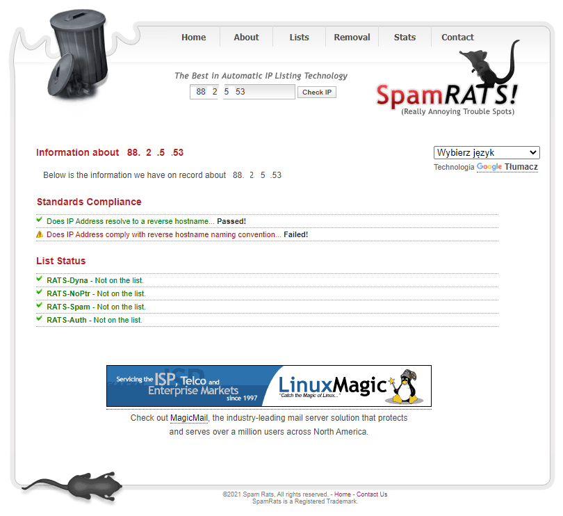

Information from the site: https://www.spamrats.com/
Whether the IP address follows the host name reverse naming convention
For my safety, I have deleted part of my IP address on purpose

I don't know where to look now.
9,703
DKIM requires setup on the sending server (private and public key storage and generation) and in public DNS (to share the public Key).
You can look it up in google and find plenty of helpers on how to configure it.
rvassar
May 2, 2018
972
You need to publish a public DKIM key for Google to query. That's the "dkim._domainkey" TXT record in my earlier post.
