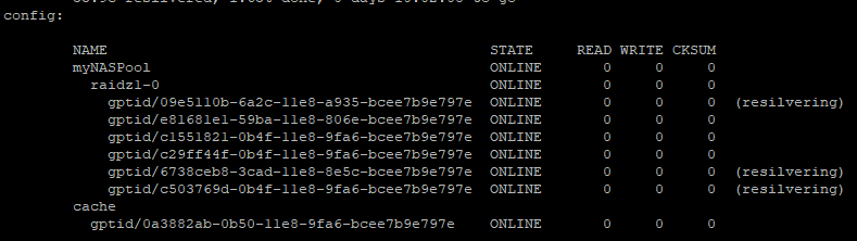

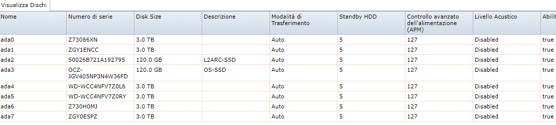

In my configuration I have 2 SSD and 2 Seagate attached @ the Syba PCI_EX card, the other disks are connected on the mobo. Forget the data about ada5, I took It for example from Internet because at that moment I was not able to take from my nas...The proplems are on 3 disks now, the first is on ADA0, where the resilvering is writing data:

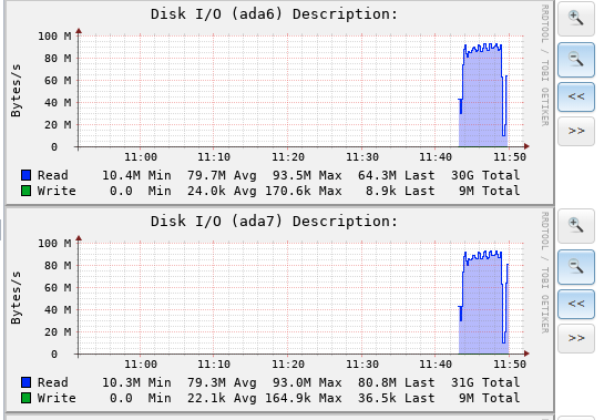

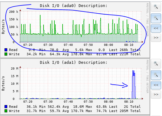

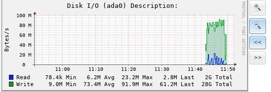

But my SSH screen shows (resilvering) also an ada6 and ada7:
Where I see there are only reads, so maybe from these two disks It resilver ada0?!?
So It starts the resilver ( as you can see now, I changed sata cables of ada6 and ada7 ) and after a while It shows detach and destruct as the example before BUT ONLY ADA6 and ADA7, NOT ADA0. In effect ada0 is attached on the external PCI_E card, so maybe can be useful to change also this sata cable. I will wait a while to see If the error occur and in case I will change It.

First of all I think you need to take a step back, you are confusing me. Are you stating that the error message you posted was not actually yours? Not sure how you expect to get accurate help if you cannot post your actual problems.
When you troubleshoot hard drive issues then you must relate the problem to the physical hard drive serial number, not just ada0, ada1, etc... as ada0 can change, it is not always fixed to the same hard drive, especially when you move the drives around.
In effect? Is it physically attached there or not? It's difficult to use guess work.
Also, the hard drives you have installed are Survellance hard drives, meaning that they are not really good for a anything other than video storage, meaning that when they read data back (If I understand this correctly), they will try to read a piece of data but if after a few retrys then it just skips the data and continues on because during video playback a little bit of data loss is considered acceptable. I have a WD Purple drive in my home DVR but I won't place one in my NAS, no way. I'm not saying that this is your problem however it could be, too early to tell to be honest.
So, was this setup working prior to replacing the hard drives or is this a new setup?
1. Specifically which ASUS motherboard and which SATA add on board (need the add-on board info so I can look up hardware configuration info, you could have a jumper issue)?
2. What are the physical connections to each hard drive and include the hard drive serial numbers?
3. Post the output of the following command smartctl -a /dev/ada0 for each drive.
4. Tell me which hard drive is connected to which SATA port location, be specific.
About this don't worry because I lost the screenshot about my errors but I have found exactly the same on the web.
I didn't move any drive so the drives are ever the same and in the same position
Yes It's attached on It
Infact they contains many many video files for PLEX
This was setted up with all WD Caviar Green, but I changed 4 of them in last months with Seagate because were old and with many errors.
1. Specifically which ASUS motherboard and which SATA add on board (need the add-on board info so I can look up hardware configuration info, you could have a jumper issue)? Asus 90-MIBJH0-G0EAY0KZ P8H61-I LX R2.0, the sata card I said before Syba with Marvell chip
3. Post the output of the following command smartctl -a /dev/ada0 for each drive. You can find six files attached, do you see any error?
Don't consider the ssd's, the order id exactly top-down

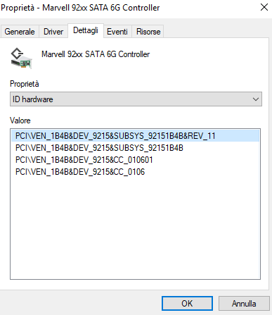

I need an actual model number of the PCIE card, trust me, it matters. Some are not compatible with the newer versions of FreeNAS. I use a PCIE card as well but I had to ensure compatibility and while it was good for FreeNAS 8.x, I have been hoping it would remain good for as long as I have my machine. One day I will not be able to upgrade to a newer version of FreeNAS due to hardware limitations but that is okay and I expect it.
I have exactly the same card on my other PC

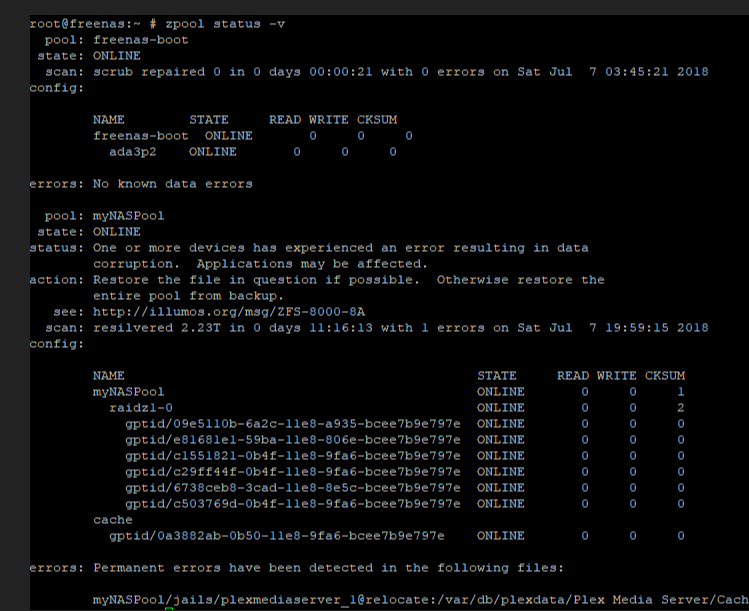

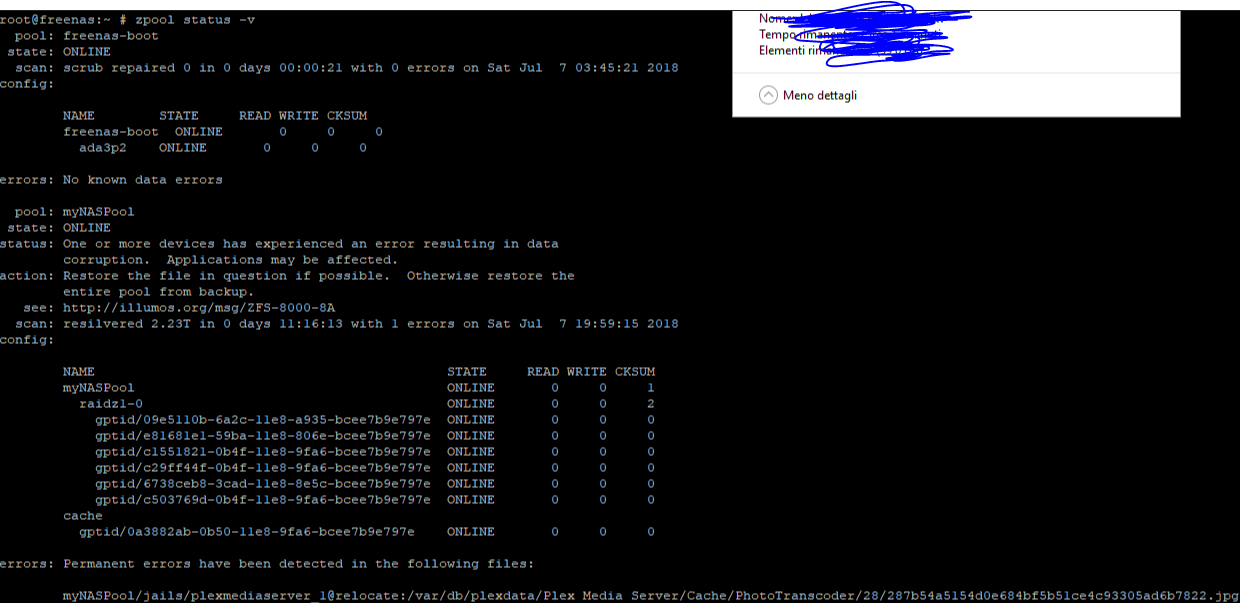

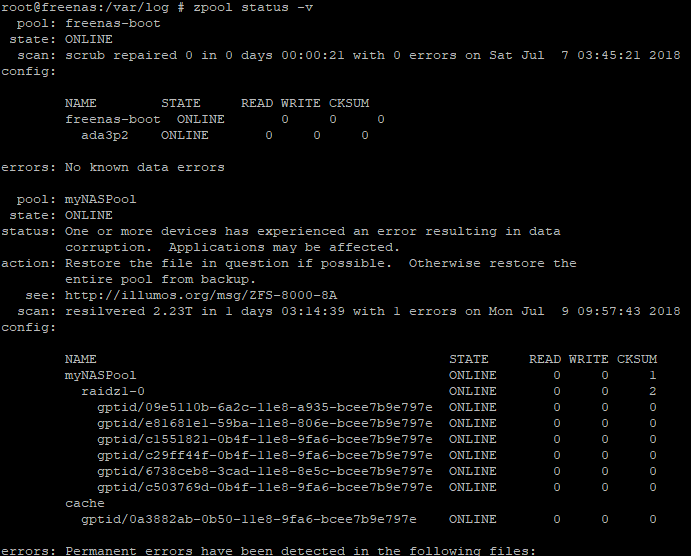

The stranger thing is that now I'm in a state where the resilvering is complete
Everything is ok, except the fact that If I reboot resilvering restart, but when I copy some movies for test from the NAS to the PC Freens reads only from the other disks and not ada0 ( for example ada1 )
So, I think I'm in a state where ada0 is completely lost, for this reason I have a checksum not equal to zero after resilvering, but the data is not lost because are on the other 5 disks, I checked many many files and they are good, anyway because of I have a backup, I can start to create my pool from scratch.
Do you agree with this?

To answer your question, because you do have a backup then I would do the following, again this is what I would do, it's not just a recommendation...
1. Power down.
2. Run Badblock on all of the drives simultaneously. you could run it on just ada0 however it's only a little longer to do them all at once and then you have that concern off the table if they all pass.
3. If Badblock passes then I'd swap drive ada0 with one of the WD drives and see if the problem follows the hard drive or possibly sticks with the port. Also, leave the SATA cables connected to the ports, you only want to move the hard drives and make as few changes as possible while troubleshooting a problem like this.
4. Run a scrub to check how the drives are performing.
