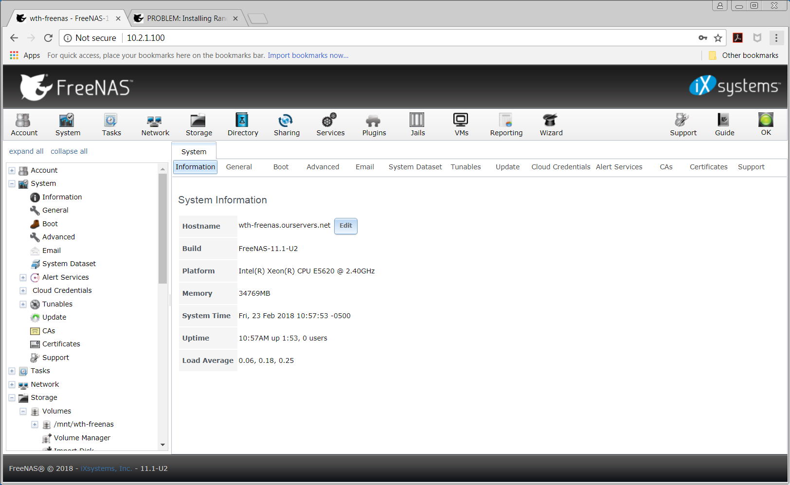

Which build version (System -> Information)?
What is the output of ifconfig?
Whoops, forgot the system information...

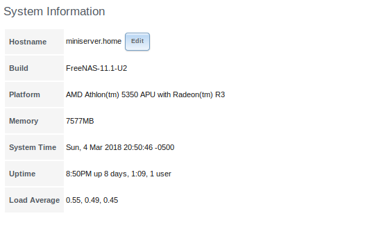

I'm running into a similar issue to ByerRA. Shortly after clicking 'Start', I receive the Image Download Failed error message. I don't have the .bhyve_containers folder appearing anywhere.
In a bid to get it to work, I created a new folder with 644 privileges. iso_files and img.gz file download from freenas link above with same privileges. I get a repeat of the above whenever I attempt to create the VM.
System info and ifconfig attached.
