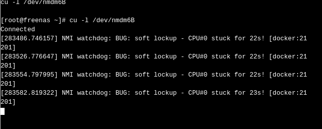

A RancherVM was built in the 11.0 series and has been pulled along into 11.2. While this Rancher VM worked well in 11.0, I'm noticing that it needs to be rebooted daily in 11.2 which means that any running containers/services get torn down as well. From the CLI, there seems to be some CPU resource locking. Any tips to resolve?
The hardware CPU is a XEON E5-2620 v4. Host hardware has 16GB RAM.
sysctl hw.physmem
hw.physmem: 17013260288
Type Container Provider
Autostart: true
Virtual CPUs: 2
Memory: 2048
BootLoader: GRUB
Com Port: /dev/nmdm6B
Description: RancherUI VM
The VM is reporting CPU#0 stuck.

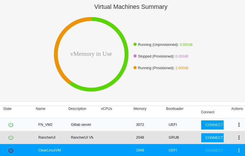

You have 16GB in your FN box but how much memory are you allocating to your docker VMs, and did you choose to overcommit memory?
If both VMs existed in FN11 before you upgraded, then the error message results from a change in memory management introduced in FN11.2. ( see here, but note exact mechanism may have changed since post: https://forums.freenas.org/index.ph...-throttled-when-using-virtual-machines.69046/ )

So, there is no overcommitted memory. I have a Gitlab VM (Ubuntu16.04) with 3072MB RAM (shows as unprovisioned) and a RancherUI VM with 2048 MB RAM (shows as provisioned). What's the difference between provisioned/unprovisioned? I followed a similar setup process for both VMs, so what leads each VM to be provisioned or unprovisioned for memory?
The FreeNAS documentation is silent on provisioning of memory. There is only a concept of provisioning for storage. So, there's a gap in the documentation.

Thanks. The python script has some self-referencing description of provisioning... not tremendously helpful for understanding other than it's pulling some state. It's still unclear to me how two VMs created within FN can lead to one being provisioned and the other unprovisioned. In service provider language, provisioning usually means a resource is managed or configured based on a known limit.

Autostart == provisioned.
