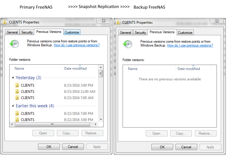

Primary unit CIFS share - I can see all files and go back to any available snapshot and pull a previous version of a file via Windows Previous Versions. (SWEET!)
Issue:
Backup unit CIFS share - I can see all the files from the replicated dataset (COOL!) but No Previous Versions Found. (not cool.....)
I'm under the impression that the Backup unit is exactly the same as the Primary via replication. All the snapshots are on both units but I can only access "Previous Versions" of files on the Primary unit.
Please help, really stuck.

It's the Shadow Copies/VSS, right click on a folder in a CIFS share in Windows and there is a Tab called Previous Versions there. In there it shows all the previous snapshots and allows the end user to copy and paste a file or an entire folder to another location or restore a file or folder in it's current location.
The issue is the Snapshots on the Primary unit work fine, but when they are replicated to the Backup unit, I get No Previous Versions Found.
Thanks again for your assistance.

I've read this page many times but you made an interesting point, follow me here:
Snapshots get replicated to the Backup unit but it looks like they can not be used as VSS Snapshots because "Datasets are filesystems and shadow copies cannot traverse filesystems".
I think this is why I can't use the replicated snapshots for VSS. Please Verify.
So in theory to solve my issue, I have to setup another "Periodic Snapshot Task" on the Backup unit of the same Dataset and I'll get VSS service back.
The down side is I'll have the Replicated Snapshots and the Local Snapshots of the same Dataset on the Backup unit.
I could negate this by setting a task to delete the replicated snapshots at a greater rate than their designated lifetime.
In the situation where Primary dies in a fire: change the IP address of Backup, change the name to Primary, delete the replicated snapshots from burned Primary, and carry on.
I'm going to give this a try and post back with the results.
Aug 23, 2016
14
SOLUTION:
That was it! You can't use the replicated snapshots for VSS, you have to setup another "Periodic Snapshot Task" on the Backup unit to have "Previous Versions" on the replicated DataSet.
