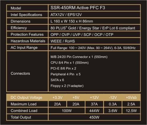

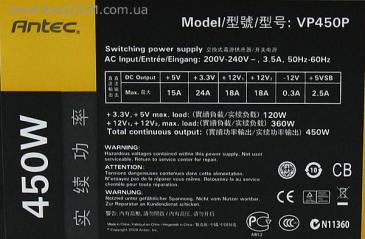

Since the build I visualize is vanilla,650 would be over kill I think.
Seasonic SSR-450RM
Antec VP-450
1/
Comparing the above the SSR-450M does take a 444W load whereas the VP-450 takes a 380W load on the +12VCD.
2/
The VP-450 has 2 x12VDC rails at 18A each, and the SSR-450RM has 1 12VDC rail at 37A.
3/
VP-450 is non-modular while the SSR-450M is.
4/
SSR-450M 80 plus rated, antec is not :)

With regards to the antec PSU although not 80 PLUS rated a hardware review put it's efficiency at between 80-85 percent, and basically said it could not be 80 plus certified as it missed something called a "PSF" or PSD or some component like that which is mandatory for a 80+. The downside is that its not by Delta its by FSP.
http://www.hardwaresecrets.com/printpage/Antec-VP450-Power-Supply-Review/1487
