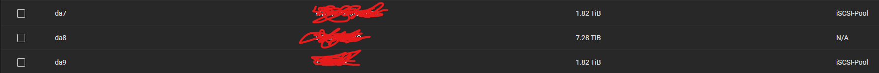

I think I encountered a bug, but I want to be sure. I am in the process of replacing all my disks slowly. I offlined the disk I was going to replace, took the disk out, plugged the new disk in, and then started resilvering. The pool went from unhealthy to healthy after the resilver completed. In the pool status, it shows the disk was replaced without issues. The disk in question is /dev/da8. However, when I look at disks, it shows that the disk is not apart of the pool.
I think it is just a graphical glitch in the gui, but I want to make sure.

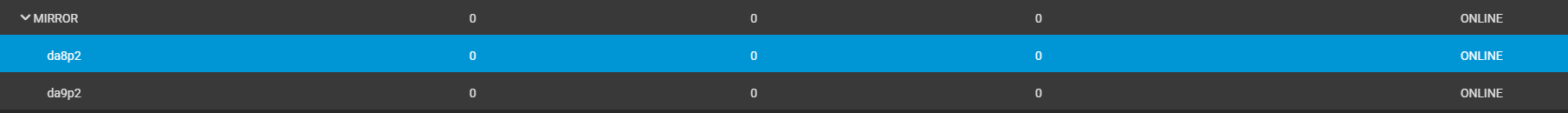

When I edit the disk from the pool status page, it takes me to the same disk as da8. I am running TrueNas 12.0 U7.

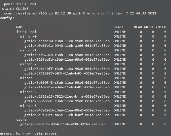

zpool status
Also, if you posted your setup we would be able to help you properly. As it is I would say the problem is because you have no CPU, no motherboard, no RAM, No disks, No HBA, No NIC and you aren't running any software
clifford64
Aug 18, 2019
87
Here is a screenshot of zpool status.
