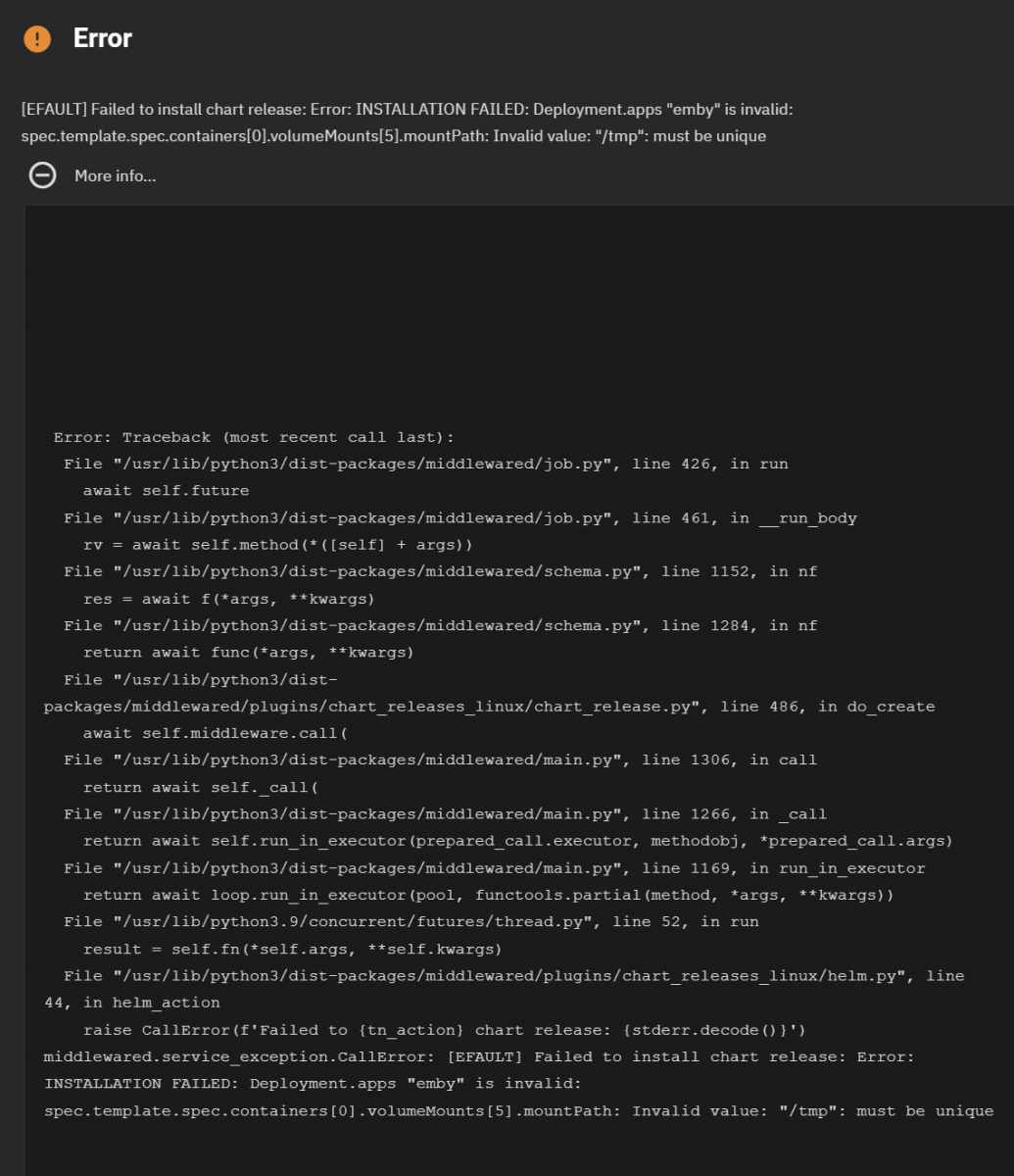

@Daisuke
I run into a issue by installing Emby, actually there was an update for Emby and then it failed, so I reinstall it.
The issue is like this :
Can you understand something out of this..???

/tmp is a host path common to many Linux based installs. It has often been recommended for transcode temp folders because if it’s ubiquity and high performance. But it’s a host path and thus under new restrictions/guidelines. I use it and deselect the warning box, but that is not the current best practice.

788
@Daisuke
Can you understand something out of this..??? View attachment 61367
The issue here is the fact you even try to add a `/tmp` mountpoint yourself.
You shouldn't do this with TrueCharts at all.

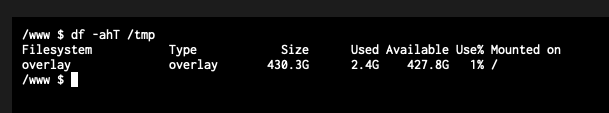

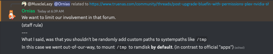

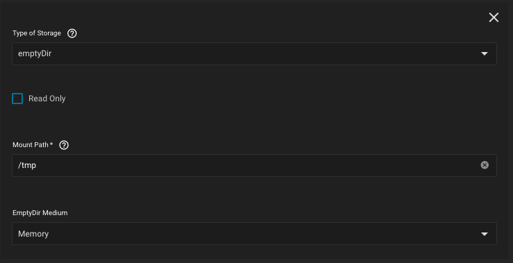

Edit: I had a chat with @ornias on Discord channel and apparently, TrueCharts apps sets /tmp as ramdisk by default (which is ideal):
However, based on my tests, it is not the case, /tmp is set as default overlay directory:
Once I mount the emptyDir as Memory, the ramdisk appears:
None of the apps I installed mount /tmp as ramdisk, he recommended to file any bug reports on Github.
I think the best approach is to test an app and see if temp directories are mounted as ramdisk, df -ahT will give you the entire container filesystem structure. For now, I'm going to remove the ramdisk recommendation from guide, to avoid confusion.
