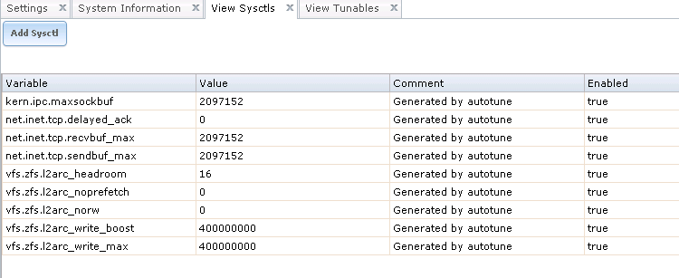

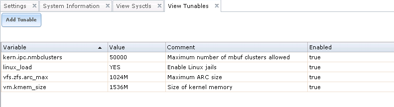

What tunables and sysctls do you have set? I see at least one custom, so I'm sure there's more. :P
Scott Mercer
Oct 12, 2014
12
There is the chance it's just a coincidence since you upgraded, but I'd do a RAM test just to be sure everything is okay.
*Something* is very wrong with your setup, and I don't think it's limited to your pool.
I agree that there is *something* **very** wrong.
As a hail Mary, I could pull the USB boot media and start completely over and import my zpools and a config. However, I don't have any sort of indication that it would be any better than what I have now.

Yes, but that doesn't rule out a RAM problem. Contrary to popular belief, when RAM goes bad all sorts of weird and f*cked up stuff starts happening. It's like a family member with Alzheimer's. She'll talk about back when she was in the civil war and you're like 'What!?'. Then she's tell you that you aren't family and you're just baffled at what comes out of her mouth.
Bad RAM fubars pretty much everything. Doesn't have to be ZFS. Every time I've had bad RAM on a desktop it has required a reload (or restore from backup) of Windows because not only did the operating system files themselves get corrupted, but the file system was trashed too.
Ok, a couple of unrelated tidbits:
1. Your *can* put 16GB of RAM in your box. So if you have wanted more RAM, that is an option.
2. An ARC that is only 1GB is terrifyingly small. The vfs.zfs.arc_max and the kmem_size both got my attention and clued me in that you had custom sysctls/tunables. BUT... I don't think that's your problem either. It could be, but I doubt it. But with 8GB of RAM, your ARC is going to be small regardless.
3. How long has this system been setup?

Yes, I will probably consider more RAM at some point. However, the current config (when working properly) seems pretty performant, so I don't have a driving need right now. In terms of the ARC, I don't recall setting that setting. I do recall tweaking the kmem_size some time ago, when I upgraded from 2GB to 8GB RAM.
This system has been set up and running since the early days of FreeNAS 8, it looks like I have a couple of saved configs going back to January 2011. The oldest release I have archived is 8.0RC2. I'm pretty sure I was running this particular config before that even.
