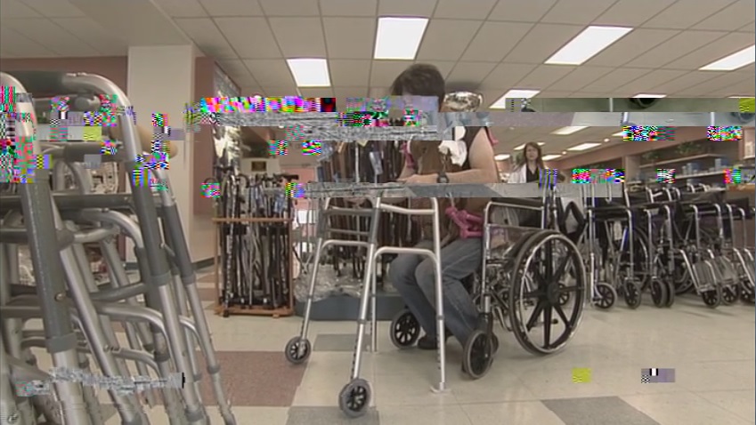

I am running FreeNAS as a media server for my home. I use it only for storing and sharing video files to any devices on my LAN. My server is about 6 months old and I believe I am starting to see evidence of silent corruption.
I have the system set to auto scrub every month, and I scrub before uploading new videos.
My server:
FreeNAS-8.3.1-RELEASE-x64 (r13452)
AMD Athlon II x2 270
Gigabyte 990xa-ud3
8G ECC Ram
6x 2TB WD Red in Raidz1
The 6 drives are connected to the onboard sata controllers.
I have one ZFS volume and 2 datasets; one for movies and one for shows.
This is the only example I have noticed so far:
Volume status reports no errors across the board. I am running a 72+ hour memtest at the moment, but am not sure what else to try if/when it comes back with out errors.
Nothing on the server is irreplaceable, but the time invested to rip, encode and organize is.
Could I be looking at a problem only in the starting or a bit of corruption that slipped past the scrub/checksum check?

The odds of corruption that slipped past ZFS is astronomically low. We're talking 1 bit in 10000 years or something. I'd bet its more likely the encode or decoder for your video is causing the glitch. I'm not sure what program/codec you were using, but you may want to try a different one. If you didn't use VLC you might want to try it. If you are a Windows user, just because you used Windows Media Player and then Windows Media Classic doesn't mean you used a different codec. Most likely both used the same codec. VLC uses it's own codec system that is strictly internal.

I use handbrake to do my encodes using x264 and the mkv container. I use VLC or XBMC for playback.
I have watched this video file before and don't remember seeing this error. As this is the first error/problem I have had in 6 months I'm hoping this is a fluke. It's possible there was a problem with this file from the beginning. I'm hoping there isn't any issue server side.

Have you opened video from server or downloaded it to pc and opened there. There are cases that intel nics have bitflips. Im guessing that if your video is old and you used old videocodec it was clean and then and "later" this year you have never videocodec wich do things just like that (have seen it for myself). For to be sure is file corrupted check sfv or md5 of that file (if you dont have md5's for files perhaps it is good time to start doing at least now). PS. memtest on your pc might not hurt either..

Very interesting point about consumer desktop grade motherboards not having true ECC support; I would not be surprised if this is the culprit. I will look into upgrading to a server grade motherboard in the future. I had to stop my memtest at 5 passes due to a power outage and the ups not having enough charge to last. I have restarted it, but am not expecting errors.
As for checking hashes, the thought had crossed my mind. I have done SHA256 hashes of my larger backups for periodic testing later on. I am also planning on doing extended SMART tests outside of FreeNAS when memtest is done.

Memtest ran for 25 passes without any errors. The extended SMART tests produced nothing out of the ordinary.
It could be possible that this file was corrupt before being copied to this dataset. I am going to put this on the back burner for now but I am going to periodically check those SHA hashes.
