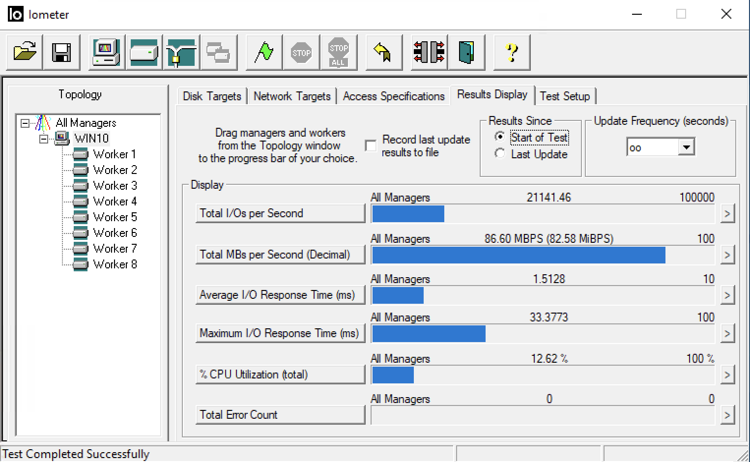

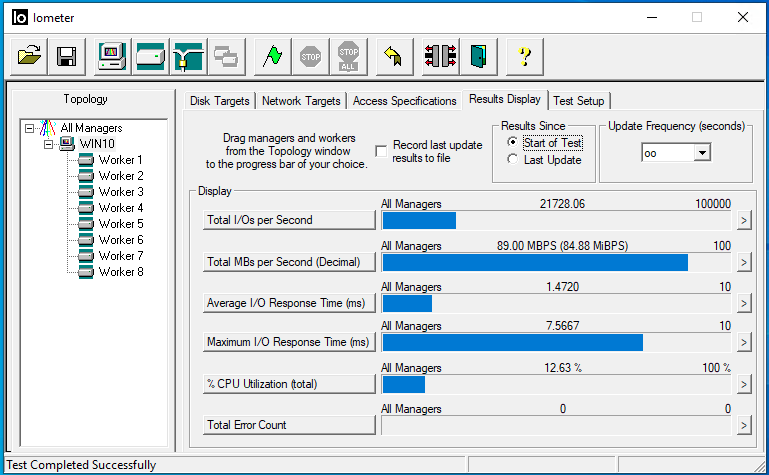

So I spent some time to do some testing, and maybe I need to try some different setups, but i found this interesting. The largest difference was response time. Is there a recommended test setup for Iometer? I did a 1GB limit, 32 outstanding I/O per target, 30 sec warmup, 1 min runtime.
Between a mirrored vdev pool and a raidz2 pool, the IOPS, and overall throughput seem to be very similar, but the response time I assume is where everyone is talking about greater iSCSI performance? Please let me know your thoughts. Thanks!
ALL DISK RAIDZ-2
ALL DISK MIRRORED VDEV
The small size of the test means it was completely captured by your ARC on reads, and if you haven't set sync=always your writes were just merrily going into RAM as well. The other challenge is that performance on a clean pool is basically the maximum you'll ever get - data isn't fragmented, there's lots of free space to write to, and with 384G of RAM you're experiencing zero cache contention.
You could try simulating a 0% cache hit rate by setting primarycache=metadata on a ZVOL (I recommend you make a second one for this) and re-running the tests. This would force ZFS to actually have to "go to disk" for the reads at least, but you can already see the difference in the maximum response time of Z2 vs mirror (33ms vs 7ms)

Since I'm apologizing already today, apologies in advance for the long post. :grin:
I really appreciate the fantastic information! I did several rounds of benchmark testing (very time consuming for sure!) and I think I found a sweet spot I can work with and be happy with the results. I made 2 pools. First a RAIDZ2 with (8) disks and ended up with 30TB for the SMB Shares, Plex, etc. I also made a mirrored vdev pool with (4) disks made up of 2 separate mirrors. I also added a 256GB SATA SSD (for now) as cache because it did show a significant performance boost in a VM. Granted as you and a few others have recommended I will move away from this once I can get a couple Optane drives installed, but for now I am pleased with the results.
I did try a full (12) disk mirrored vdev with cache and the VM performance was incredible. But I am not quite ready to throw all the stuff in the SMB shares into a Windows based VM just yet. Maybe version 2.0 will be a full shift in that direction. :)
I absolutely will be keeping this thread handy as I continue my work on this system, but so far things seem to be coming along nicely, so thank you all for the fantastic information and suggestions! MUCH appreciated!
You're welcome. But I suspect you called "cache" (= L2ARC) what is actually a SLOG. For the safety of your pool, replace that one with an Optane drive or a Radian RMS-200/300 (there's a handful of these on eBay right now) as soon as possible.
