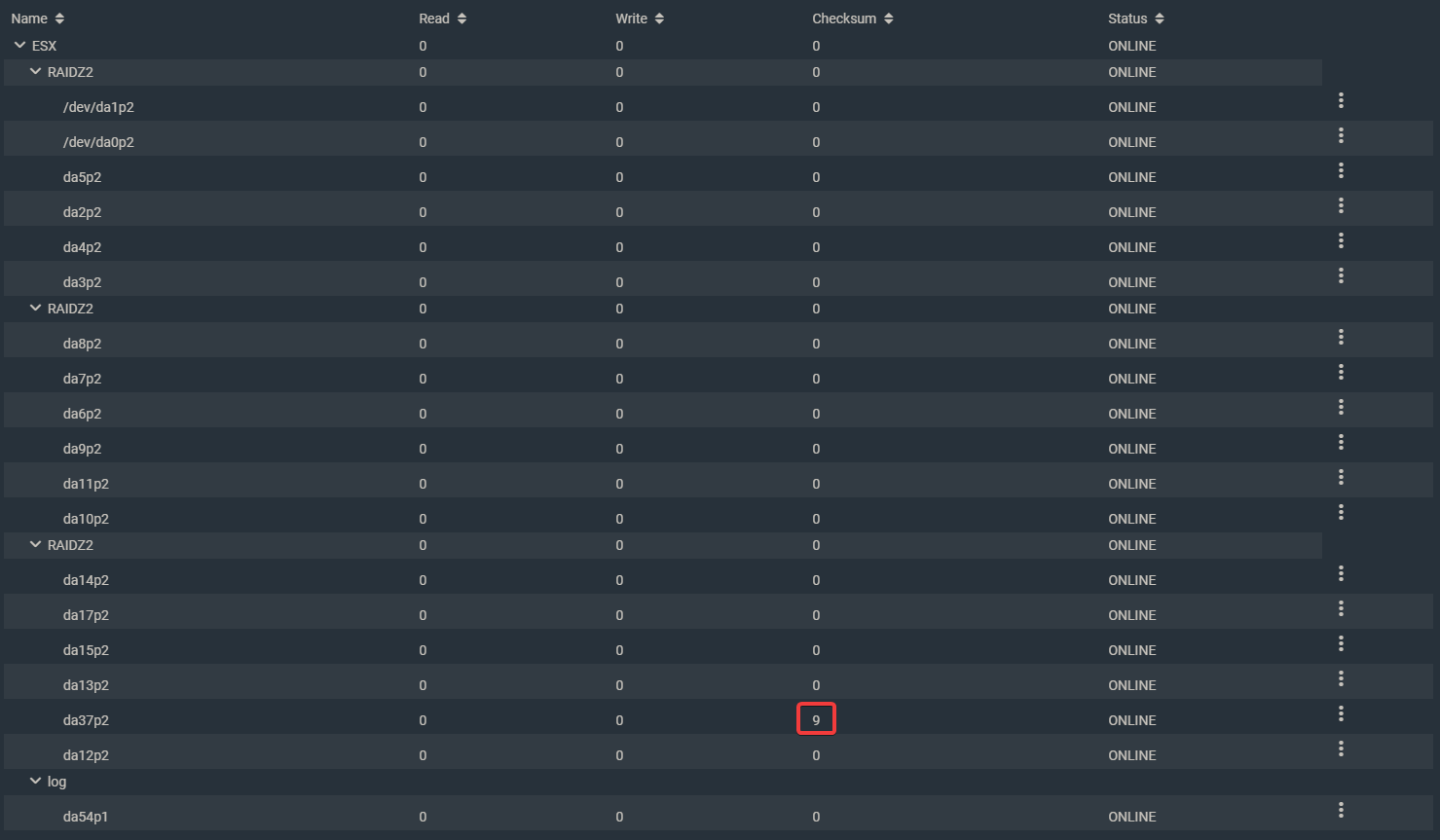

The strange thing is, the last of the RAIDZ2's keeps having one disk go bad with checksum errors.
No SMART errors reported.
If I replace the disk, it'll resilver fine and then the checksum errors start again.
This will happen even if the disk is in another spot in the enclosure, or even in another enclosure!

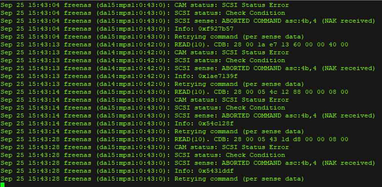

Along with this, /var/log/message get's spammed with this:
da12 -> da17 as far as I can tell, so it's the same RAIDZ2 as the slot that keeps failing.
Oddly enough, da37 doesn't show up in the logs.

Cables are good, it's an old SC213 chassis with two LSI SAS controllers in each enclosure.
As I mentioned I can choose any physical drive, on a completely different controller and / or enclosure, and it'll do the same thing.
Resilver always completes, then starts tossing checksums after maybe 10-15min.
Scrubbing completes but doesn't fix it.
FreeNAS 11.3 U4.1
For good measure I powered it all down and replugged all the SAS connectors, molex power and reseated the drives. Still the same.

I'd suggest filing a bug report...... if you can provide access to your system remotely. If neither resilver or scrub fix the problem, there is unusual behaviour here. It will probably be almost impossible to reproduce and may be hardware related.
The good news is that with Z2 your data is safe, you can still lose a drive and have a checksum error.
Does the checksum count increase overtime.... might be only one bad block/checksum and it counts each time it is accessed.

It's increasing over time, the rate increases if writes increase, I guess that makes sense.
