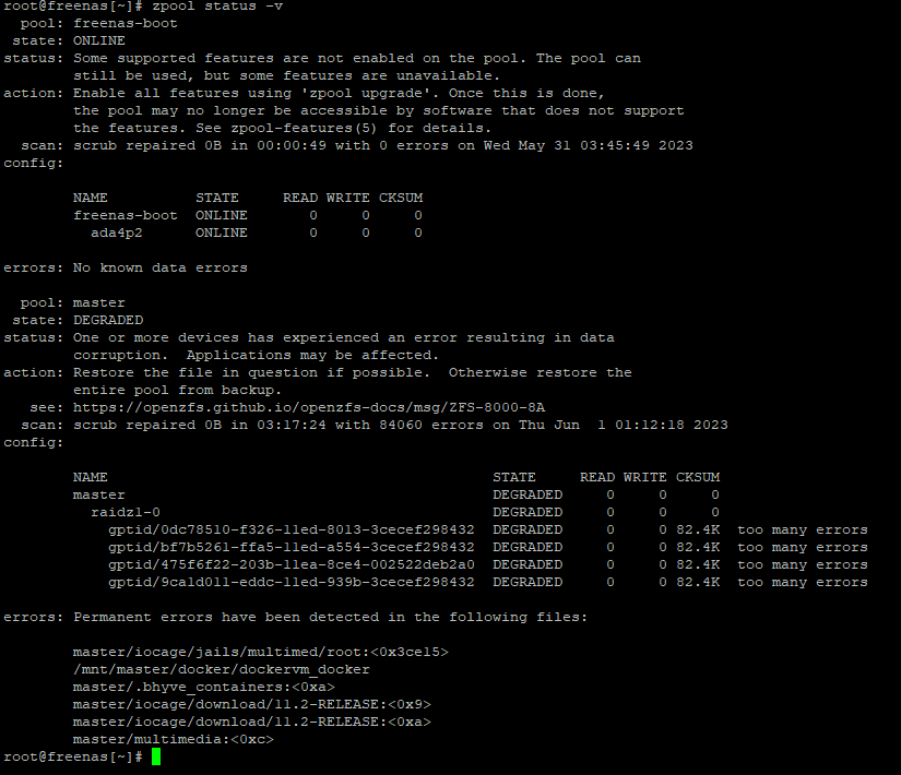

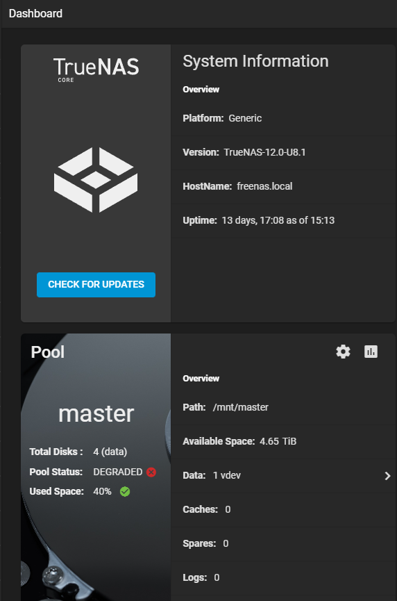

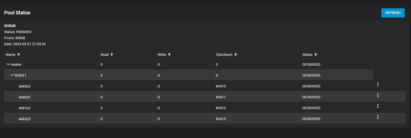

I have a TrueNAS system with 4 3TB WD HDD.
3 of those HDD are brand-new (not older than a month, because I had problems with a disk in the past. So I replaced the disk with the problems, made a zpool clear and a lot of scubs, but the error count is not going down.
I also tried to delete the files with the error and made a clear and scrub again, but it did not work.
So I don´t know what to do from here.
Has anyone an idea what to try next?

Have you checked/reseated the cables? The error numbers are all identical (82.4k) and that is very unlikely.
I changed all the cables and replaced them with totally new ones. The numbers are identical on 3 disks (84.415) and slightly different on one disk (84.511 - which used to be the EFAX disk).

How can I get rid of the permanent errors? I tried to delete all the files, but the files (in the picture above) remained.
Or is the only option the make a complete reset?

The safest thing to do is to destroy your pool and recreate it, and then to reload the contents from backup. However, try running a scrub to see if those files can be repaired.

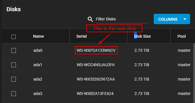

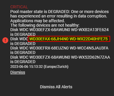

I just found out that there seems to be something wrong with the disks. In the new alert (screenshot 1) there ist the serial number of the old EFAX-disk.
But when I look under "Disks" the new disk is displayed and not the old one (screenshot 2).
How can the new disk not be added properly to the pool?

Thank you very much you all for your response, I whiped the data and set it up new. Therefore the problem is solved and the thread can be closed.
Looks like you've worked it out already, but just for clarity, that alert is older than the action you took to replace that disk and the correct data in the current view confirms all is good.
