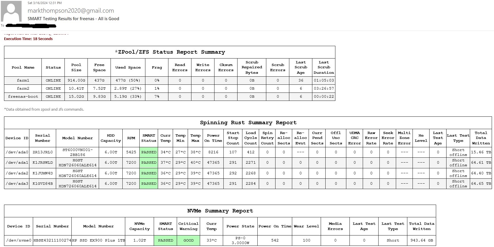

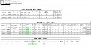

People use Multi-Report for various reasons, my reason for creating the script (shortly after I joined the forums) was to ensure my drives were being tested as I expected. Let's face it, FreeNAS 8.0x back then had some issue, and TrueNAS has a few issues as well, mostly caused by user action, but not by doing something wrong. However the TrueNAS software could be updated to notice the change and send an alert, but it doesn't, not yet at least.
If you have your TrueNAS all setup and SMART tests are scheduled as you desire. Months later you need to replace a drive for some reason, it does not need to ba a failure, it could be that you want to stick in a larger drive, or replace a HDD with a SSD. Regardless you replace the drive and several days/weeks go by and you notice SMART tests are not being conducted on this new drive. You would not be happy.
Why would this happen? Because TrueNAS uses the serial number to identify which drives were setup for SMART testing. If you do not go back into the GUI and setup SMART testing again for this new drive, TrueNAS will run normally, no alerts, nothing.
So this script was born to toss the user a quick email stating all is good or not so good. Below is a screen capture of the chart section. Below this is a text section to look at should the script tell you there is an issue. This script have evolved a lot, now someone can run the script and send me directly an email (using the '-dump email' switch) with a good amount of data (nothing personal except your real email address, which I never share) and I can diagnose the problem and provide a solution.
