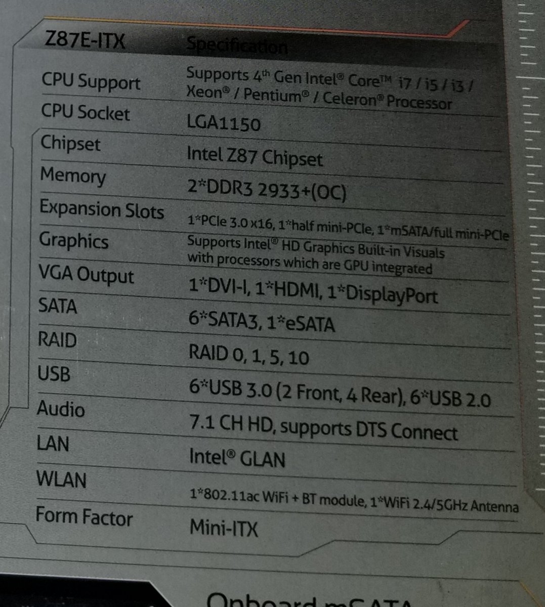

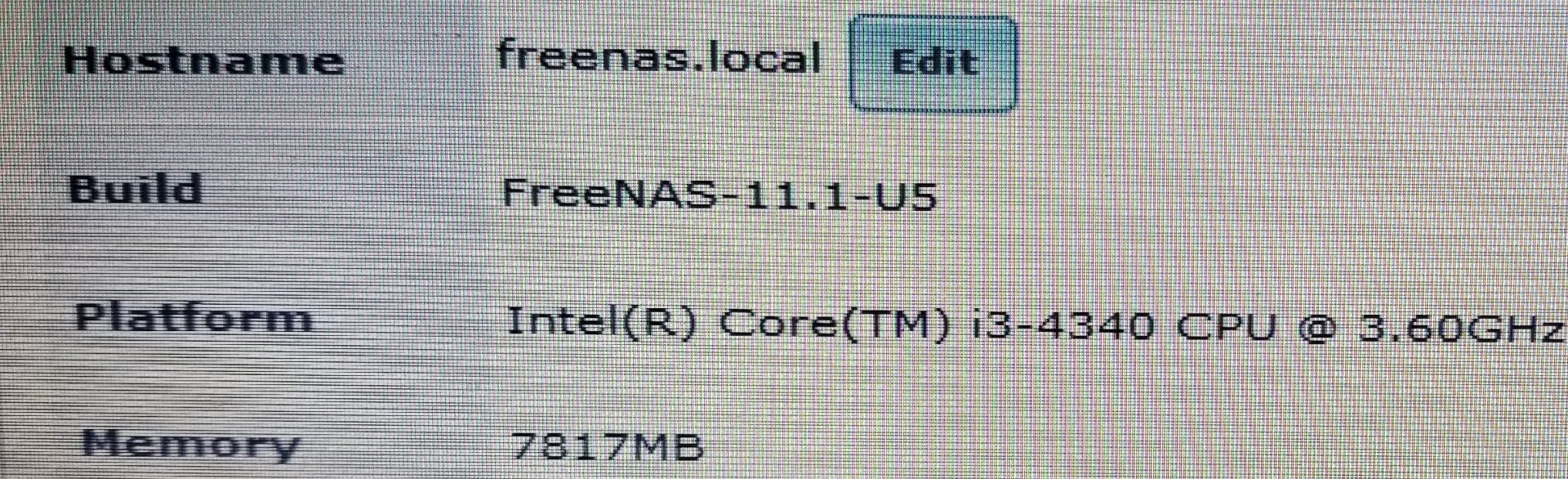

Hardware specs please.

You're not running enough memory to be running plugins, especially Plex.

Ok thanks. Add another 8gb? Do you think that's what the issue is? The cpu good enough still? I only stream 1 show at a time and dont have issues unless I lose electric power or sometimes after a restart from a update

Yes add another 8GB. It should bring some stability to your system but you still need to address the power outages with a UPS.
