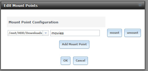

Unable to edit mount points
I run a 64 bit FreeNas 8.0.4 Release as a production system.
I have setup a second system to test freeNas 8.2 beta 2. unfortunely i only have 32 bit hardware for testing.
All install without problem, until i try to edit mount points for plugins (miniDLNA and transmission), i can not mount them and i get no message as feedback.
Is this a bug? Please help!!!

@Pierremenard and @Jagjag
"mount_nullfs /mnt/volume/whatever /path/to/your/jail/mnt/blah"
mount "outside" the Jail.
