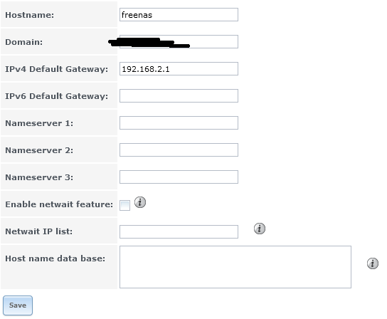

Network Settings -> Global Configuration -> IPv4 Default Gateway -> 192.168.2.1 (router IP)

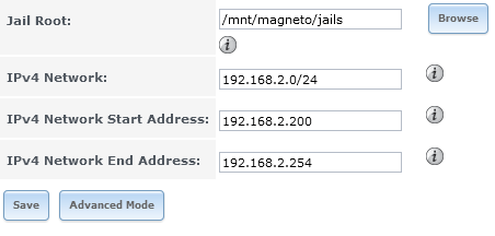

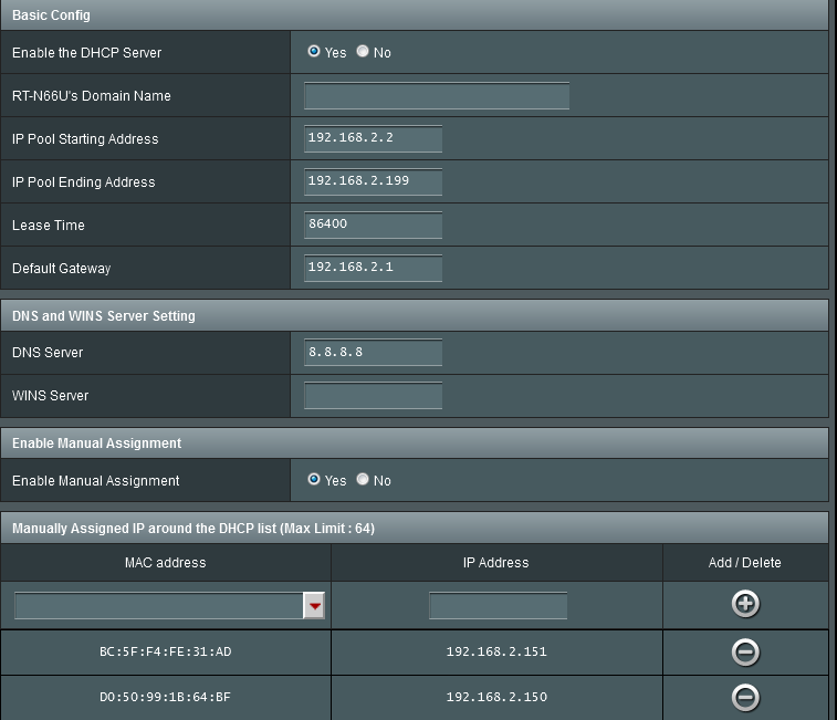

I've changed DHCP range to 2-199 and jail range to 200-254.

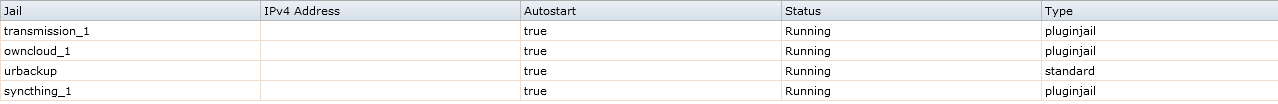

Jails config
Jails
General config and router DHCP settings

In your screenshot in FreeNAS the jails do not have an IP even 'though they are running.
Assuming you noted down the MAC's correctly, and suggesting you take the two IP's in your router out of the DHCP range (:)), and you rebooted stuff, I can think of two things now:
  1. Short term: keep the static IP's as they are in your router, and assign them in the corresponding jails also. I know I said not to do that, but we need to get something to work here.
  2. Long term (tomorrow...:D): go buy decent hardware, install pfSense, put your ISP-appliance in modem only, and never be bothered again with this crap that is stealing your most precious asset, your time, from you.
BTW: where did you get the MAC's from the jails from? Router log?
