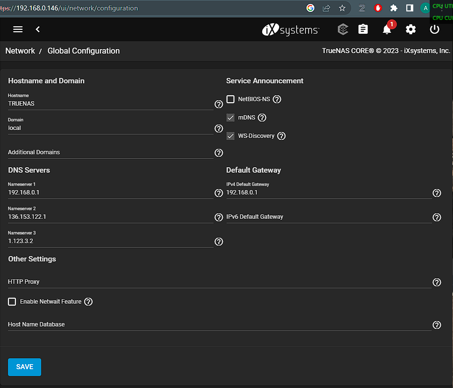

I have been having problems with plugins since I got up and running. I managed to get Next Cloud installed but it was not working so I tried to reinstall and that failed. Now when I go to install any plugin, before I have the option to create a jail name or anything I am given the error:
Cmd('git') failed due to: exit code(128) cmdline: git clone -v https://github.com/freenas/iocage-ix-plugins.git /mnt/Pool 1/iocage/.plugins/github_com_freenas_iocage-ix-plugins_git stderr: 'Cloning into '/mnt/Pool 1/iocage/.plugins/github_com_freenas_iocage-ix-plugins_git'... fatal: unable to access 'https://github.com/freenas/iocage-ix-plugins.git/': Could not resolve host: github.com '
after I press close on the error there is an endless loading circle that forces me to cancel out. I am very new to TrueNAS core, can anyone give me some instructions that could get my plugins working? Thank you in advance!

Ok now when I just go to select plugins from the side bar it gives me the error:
[EFAULT] Cmd('git') failed due to: exit code(128) cmdline: git clone -v https://github.com/freenas/iocage-ix-plugins.git /mnt/Pool 1/iocage/.plugins/github_com_freenas_iocage-ix-plugins_git stderr: 'Cloning into '/mnt/Pool 1/iocage/.plugins/github_com_freenas_iocage-ix-plugins_git'... fatal: unable to access 'https://github.com/freenas/iocage-ix-plugins.git/': Could not resolve host: github.com '

Your NAS doesn't have working DNS, which you can likely resolve by setting DNS servers. But you shouldn't be using plugins in any case:

I have all 3 DNS servers set and an ipv4 gateway set but it is still giving me the same error.

Probably. Like I said, DNS is broken on your server. Can your NAS ping the DNS servers and the gateway you've set up?
15,504
Should my gateway be the same ip as my trueNAS static or no?
No, it should not. What is the IP address of your NAS? And your gateway? And the DNS servers? And how did you determine what to put in those fields?
I honestly selected random numbers. Where am I actually supposed to get them from...? XD I just selected different random numbers and it let me successfully install plugins.
I truly thank you for your help.
These are the new numbers.
No wonder they didn't work, then. It's highly unlikely that the addresses for nameserver 2 or 3 are valid, but your router likely acts as a DNS server itself, so that doesn't interfere. I'd suggest 1.1.1.1 and 1.0.0.1, respectively, for those two.

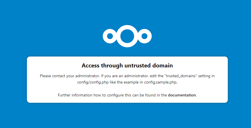

It seems like it is working. If it is working is there still a need to change anything? I was able to install Next Cloud plugin and MineOS. MineOS is working perfectly and I have a server up and running.
Next Cloud though, when I go to log in says:
any idea why I am getting that wall?
