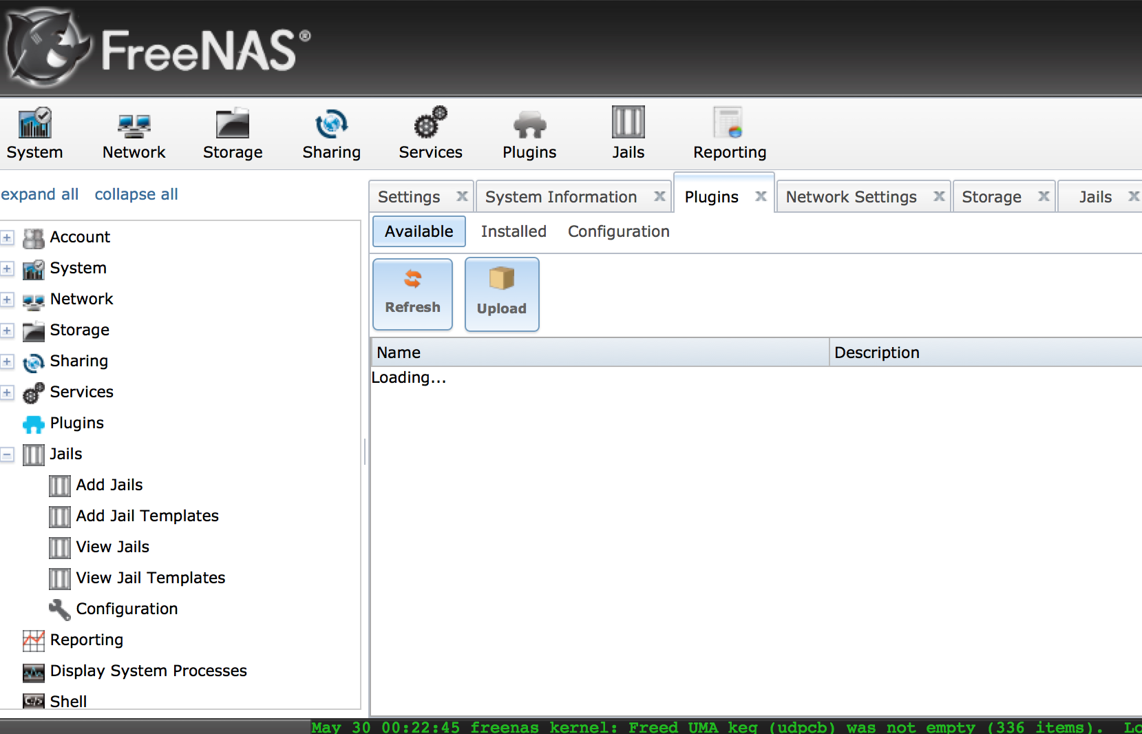

Does anyone know why when I go to plugins the list doesnt actually display anything? The odd thing is at one point it listed plugins I could install now it doesnt. It just sits there at loading but nothing ever shows up.

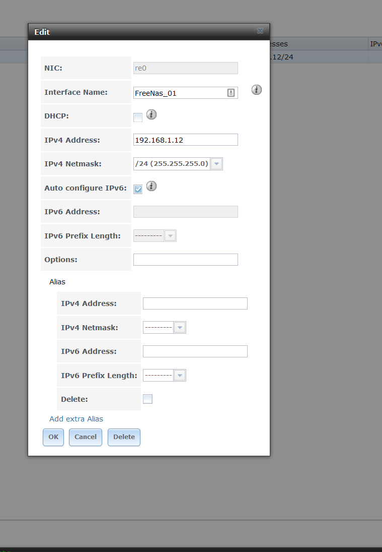

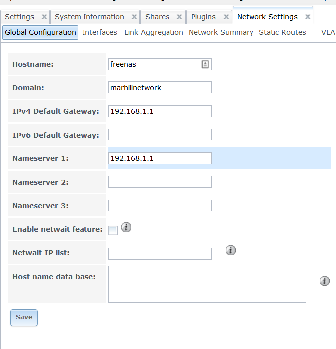

I refresh and get nothing. Can you look at my screen shots and tell me if im missing something

What version of FreeNAS are you running and please give us a listing of your hardware.
Lets jump into your GUI, open Plugins -> Configuration. Assuming you are using version 9.x and 64 bit, the web URL should be: http://www.freenas.org/downloads/plugins/9/x64/pbi-meta/pbi-repo.rpo
Your network setup looks fine to me. Could you post a screen capture of the Network Summary screen. I'm not expecting anything to be wrong but you never know. Also can you uncheck the Autoconfigure IPv6 and save that, then reboot and give it a shot. I'm shooting in the dark here.
