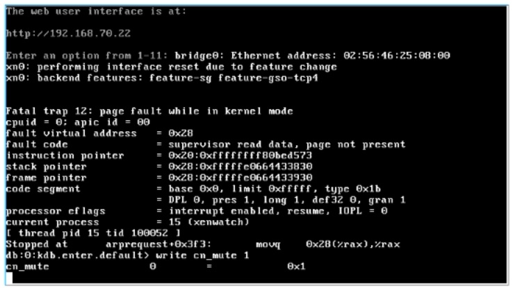

Issue: Plugins with vnet not installing or running. (I can install a plugin without vnet box checked but DHCP fails and it doesn't start)
Cause:
- Nothing in messages log that i could see.
- Console error as per below.
I couldn't find any solutions in this forum but i did find reference to similar behavior in the freebsd forums.
I can reproduce this issue from shell with:
# ifconfig create bridge
# ifconfig bridge0 addm xn0
- https://bugs.freebsd.org/bugzilla/show_bug.cgi?id=216304
- http://freebsd.1045724.x6.nabble.com/xen-vimage-kernel-panic-td6276708.html
My system specs are in my signature.
