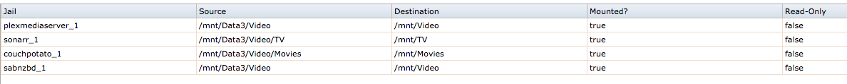

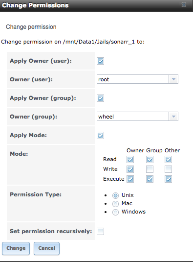

My setup is pretty much defaults. Dell T20 with 16 GB RAM and a 16 GB SSD for FreeNAS and 3 X 2 TB Drives for storage. I created 2 local accounts-mine and the wife (for SAMBA access) and both were added to the wheel. I then created 3 SAMBA shares, 1 on each drive-Data (Docs, pics, etc), Backup (for her PC) and Video (Movies and TV) with default permissions on all 3. I also added a TimeMachine share for my Mac. Once done, I rebooted and can access any of the shares from either computer. I then installed the Plex, SABNZBD, Couch Potato and SONARR plugins. Storage was added pointing to the Videos location. I see Root as the owner (user) and Wheel as the Owner (group) for all 3 but the group does not have write permission. From what you are saying, if I read it right, I need to add media to the wheel and everything should work allowing me to delete items after they have been watched?
All permissions for all folders look just like this
Apr 9, 2015
1,258
Permissions have to be changed via command line.
