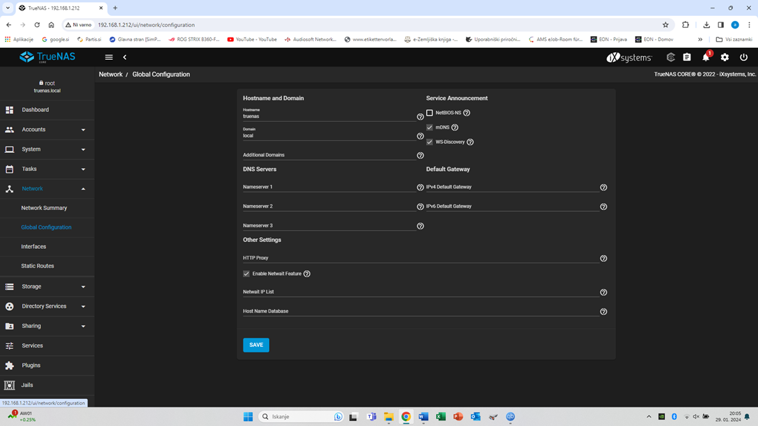

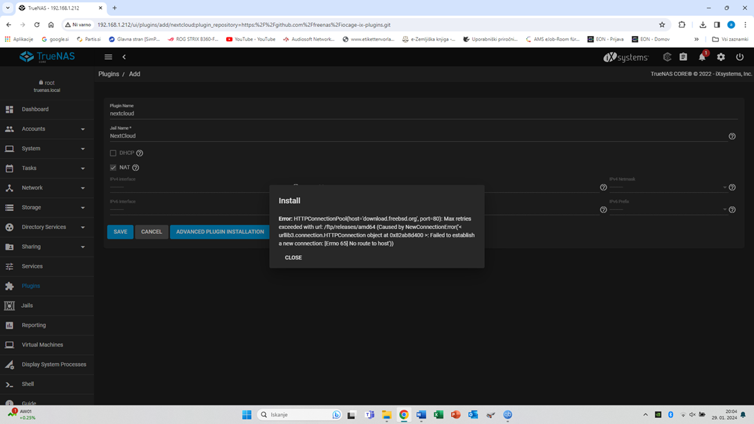

Hello truenas community,
I cant install any plugins. What can I do.??
Patrick M. Hausen
Nov 25, 2013
7,776
Configure your default gateway correctly. Network > Global Configuration
