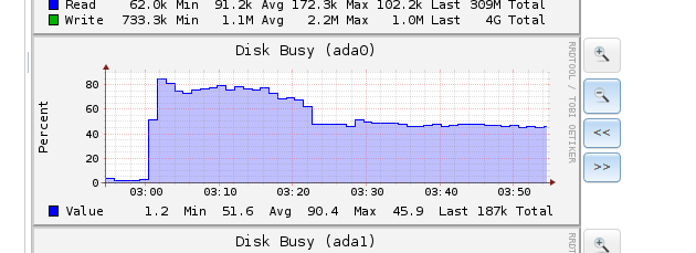

Can anyone tell me anything about the Plex server ../var/log/maillog file in my Plex jail? My maillog file has about a bunch of entries, 40,798 KB worth :
Sep 27 02:59:05 plexmediaserver_1 sendmail[89747]: w8LA4Go9057312: w8R6udQl089747: return to sender: Cannot send message for 5 days
There are about 20 related entries per second in the log and I think this my be the reason the volume running my Plex jail is always running about 80% disk busy.
I looked around Plex for a feature to sending email reports to turn off but I can't find anything.
Thnx,
-TAC

TAC
Feb 16, 2014
152
Looking in my Plex jail I see the /etc/periodic folder with sub-folders daily, weekly, monthly, and security but don't see any periodic.conf file. Should I just create the file?
This has to be some periodic task that is running. This image shows Disk Busy running pretty low and at 3 am jumping. If I restart my Plex jail this drops to almost zero and will then again, @ 3 am, jump and stay there.
