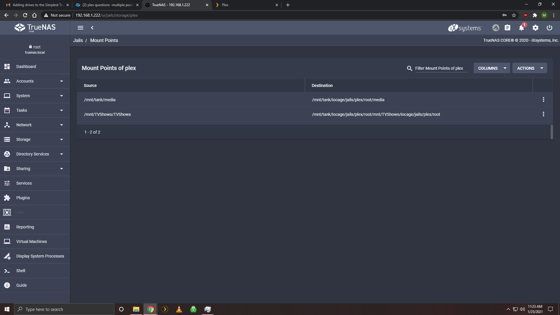

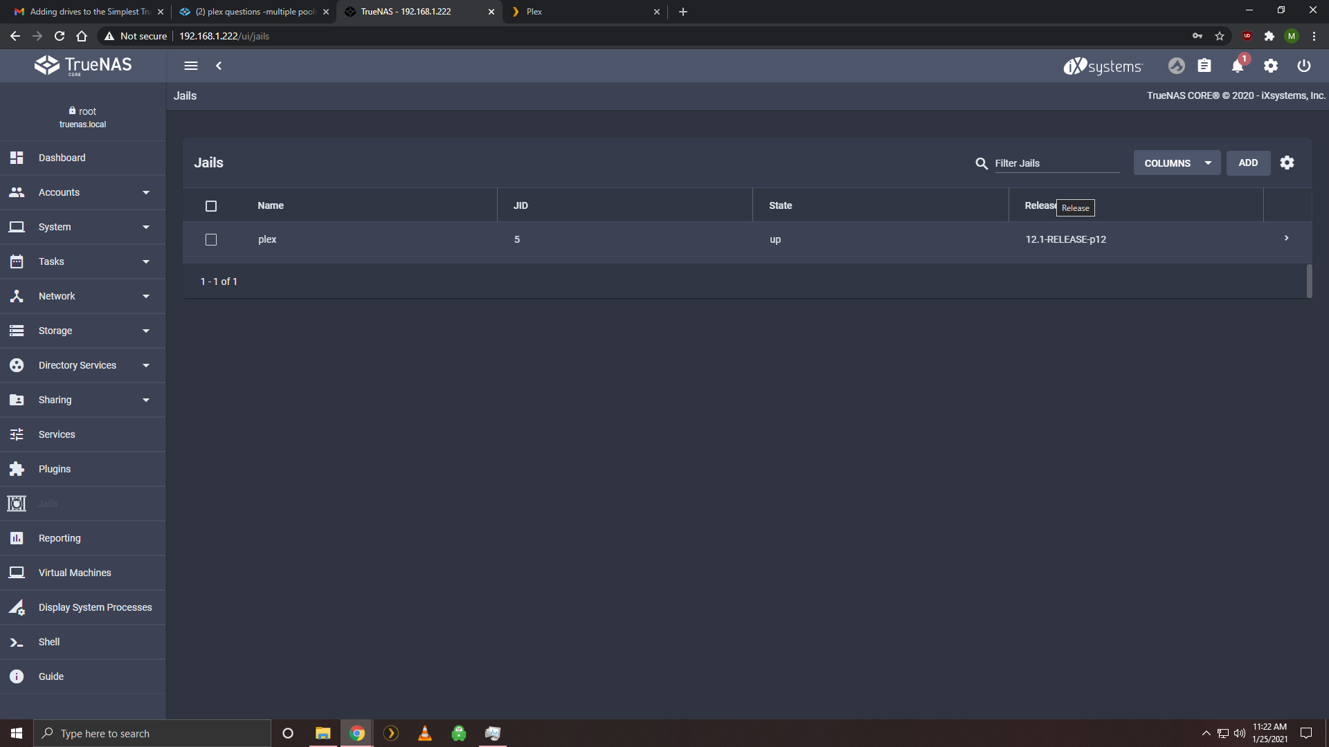

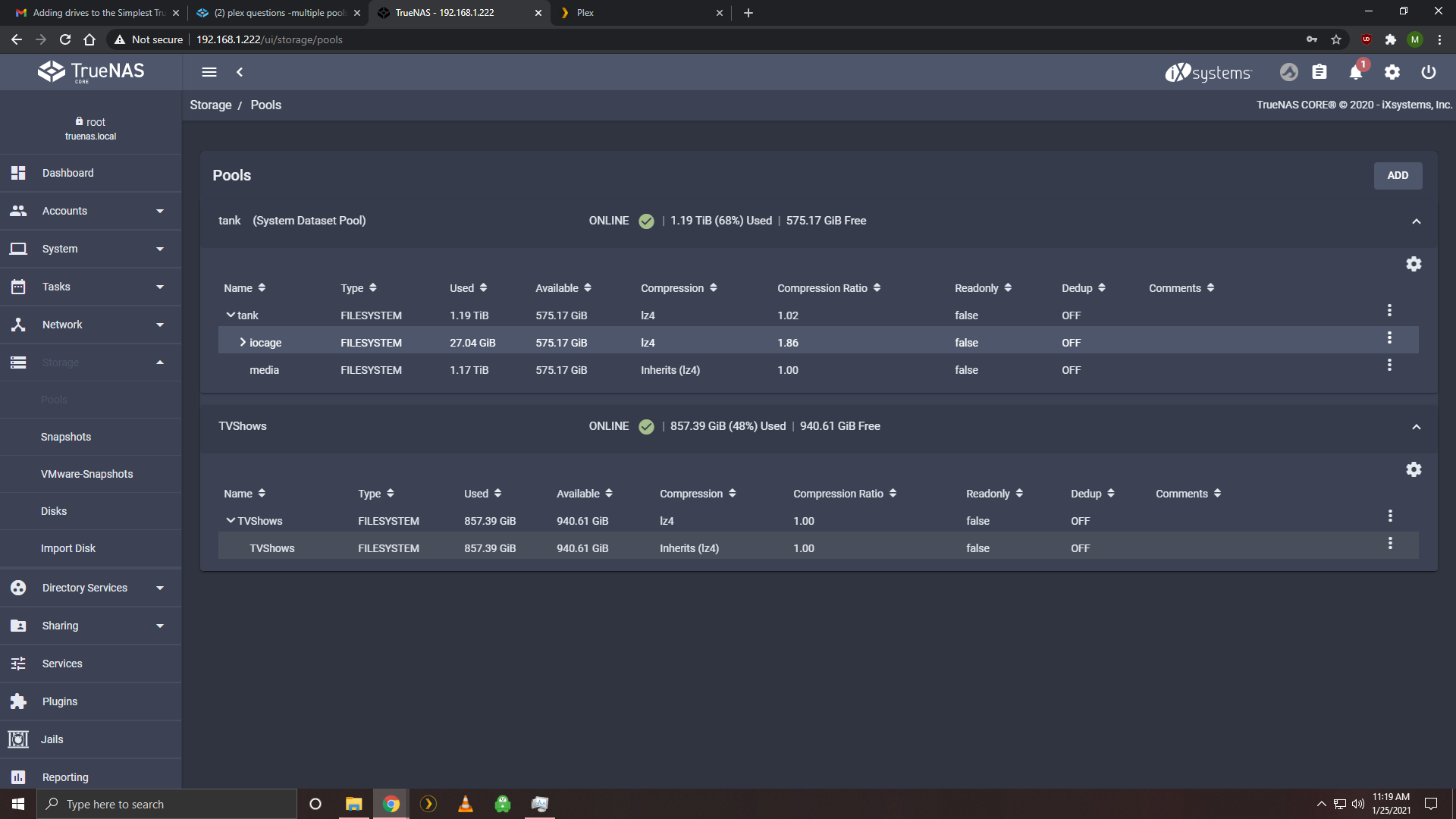

adding some screenshots here, as illustration...
So you can see the two seperate pools/drives, the jail and the paths for each mount point.
9,703
OK, so there's your problem in the last image...
/mnt/tank/iocage/jails/plex/root/mnt/TVShows/iocage/jails/plex/root isn't even close to something that should be there.
It should just be this:
Then in your plex library, make it look for /mnt/TVShows.
apologies, I explained in a prior post that when I let the tvshows mount point to the tank volume, it didnt work correctly anyway. Not sure why, but it wouldnt see more than a third of my content, and none of any content added after that. Its why I began thinking it needed a mount point referring to the tvshows volume, but cant seem to make that change either, it simply takes what I type into the path field and adds it on to the end of its default path, as you see above.
OK, I had to reread your post more closely...I updated the path as you indicated and things are updating, appears to be adding content...will report back later. Thanks sretalla!
JFC, its now telling me the directory must be empty? It refuses to save the mount with that dest path.
9,703
Indeed a prerequisite for mounting a directory in a jail is that the target is empty.
Because you had previously mounted it into a subdirectory of that one, it would have the old intermediate structure inside (so is not empty).
You will need to do something like this:
iocage exec plex rm -r /mnt/TVShows/iocage
