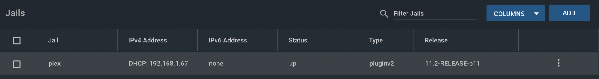

Hi folks. So my Plex plugin isn't starting. The status says is "Up" but it isn't running. I can't see it on the webpage nor on a client.
The last thing I did was try updating the plugin but I don't think it updated. The version it says is 11.2-Release-p11 / Type pluginv2.
What can i do?

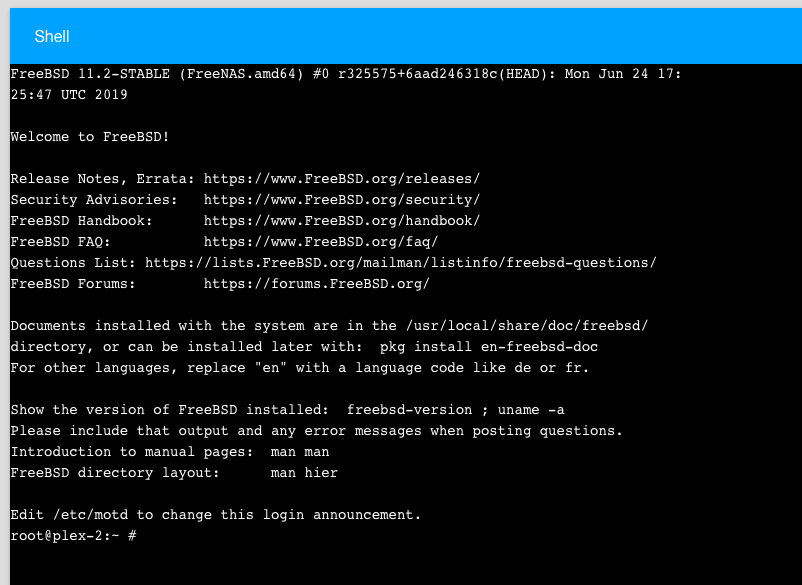

There's no reason at all to expect that this user would be present in the jail, so that's to be expected. What's not to be expected is that it'd be asking for a username/password at all. If I install the Plex plugin, go to Jails, find the jail, click the three dots, and select "Shell", this is what I get, without any keyboard entry of anything:

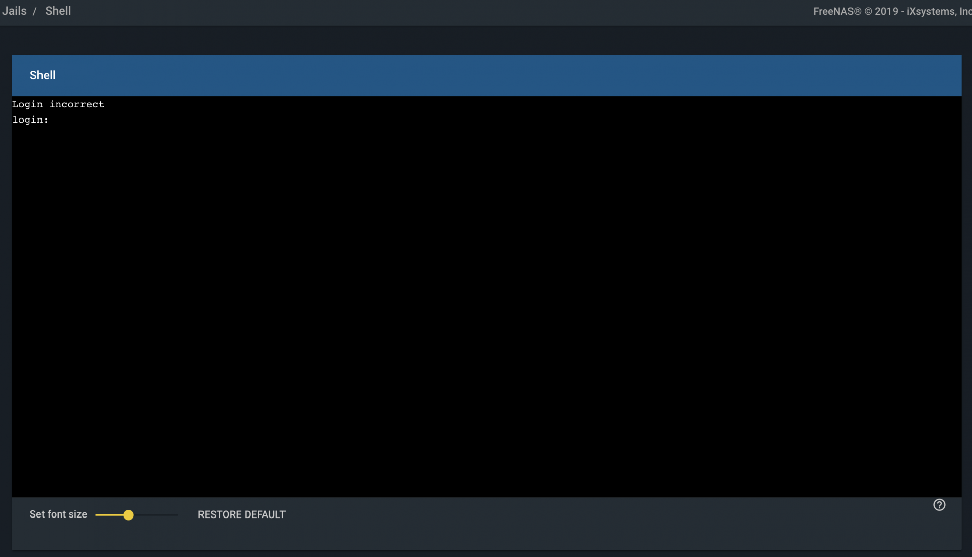

This is what I get when going to the shell.

I'd blow that jail away and start over, you've got a serious issue there.
Edit: What browser are you using and have you tried a different one? Do you have any security related plugins running on your browser?

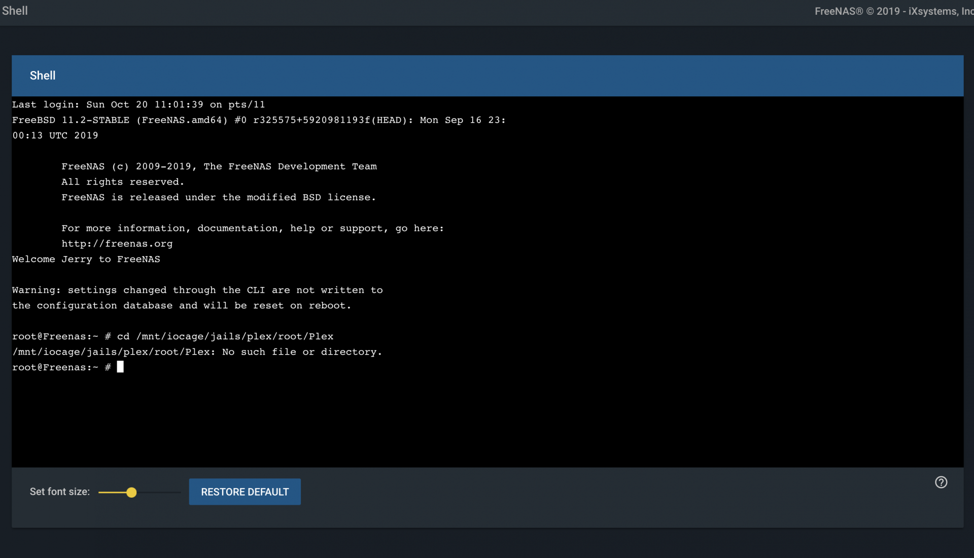

@AltecBX, it looks like the metadata is stored in /Plex/ inside the jail. From the FreeNAS shell, you should be able to see the contents of that directory by running cd /mnt/iocage/jails/plex/root/Plex followed by ls.

This is what I get when I do it. "No such file or directory"
