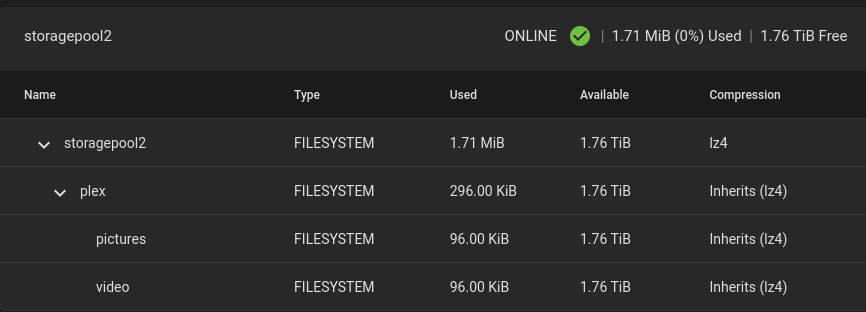

Uh, oh, wait ... how to I do that ... populate the dataset?

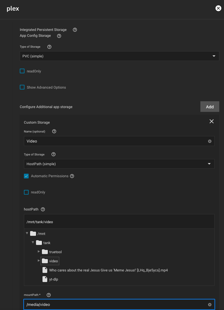

Do you mean populating the path to the dataset within the app? If so, you do that in the storage options within the app settings. Go to Apps > Installed Applications > "..." on the Plex app > Edit
In the iX version of Plex you select "Enable Host Path for Plex Data Volume" and that opens up a path field that you can point to your dataset.
In the TrueCharts version of Plex it likely has the data volume set to "PVC" which means to a location local to the app itself. You change that to "Host Path (Simple)" and then populate the path field to point to your dataset.
Save and reboot and you should then be able to access the dataset from within Plex.
Note that your permissions need to be considered in order for the app to be able to read/write correctly from that location.
OK, that makes sense. There was a warning in the setup that any choice other than PVC might cause problems.
I was wondering how it would know where to look.
Once I do that then I'm guessing I can SSH in and transfer files from my laptop to that location on the server.

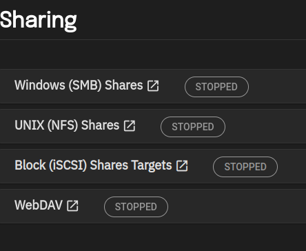

Mr. Tai's suggestion is probably easier. You can add an SMB share in the Shares section and connect to that with your laptop. Then it's just drag and drop.

Why SMB as opposed to the UNIX and the other option (which I can't recall at the moment)?
My laptop is running Linux.

OK, it's a little weird (and someone needs to replace FreeNAS with TrueNAS in the text), but it seems that SMB is cross-platform compatible.
https://www.truenas.com/docs/core/uireference/sharing/smb/smbsharescreen/
Weird because almost everything from the MS version-of-windows world seems to be more vulnerable and one argument for SCALE is that it's Linux (thus, like BSD) generically less vulnerable.
But, at the moment, it seems that SMB is the most user-friendly method provided. Yes?
(I looked at the other three and they appear to be far more complex than I have time for just now.)
I don't think this is what you'd want to do, at least not exactly. The TrueCharts Plex app uses PVC for the Plex config/metadata, as they do (IIRC) for all their apps. And while it is possible to change that to Host Path or other options, I know they strongly discourage that--I think one of the reasons is that PVC allows you to roll back to an earlier version with its metadata/config. What I think you'd want to do instead, on the same screen, is "Configure Additional app storage", and set up the path you want to share with the Plex container:
(repeat as necessary if you have more than one directory to share with the container)
Then create file shares for those directories using your desired protocol, and copy away.
As you later found, SMB is supported pretty much everywhere and works pretty well pretty much everywhere. If your only client machine is Linux, you could just as well use NFS if you'd prefer.

I have SMB working and transferred a bunch of folders with pictures.
When I try to access them via SMB - Plex doesn't see them.
Do I need to create Media Folders in Plex and then copy the pictures into them?
