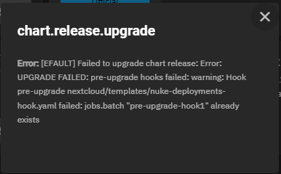

After a power outage during a Nextcloud update, the Chart is unable to start. When trying to update again, I get the following error:
[EFAULT] Failed to upgrade chart release: Error: UPGRADE FAILED: pre-upgrade hooks failed: warning: Hook pre-upgrade nextcloud/templates/nuke-deployments-hook.yaml failed: jobs.batch "pre-upgrade-hook1" already exists
I already tried a rollback but success, it still won't get past the “deploying phase“ and the hook error still persists.
There are also no logs loading for the chart.
What can I do?
Complete error:

Hi i have the same problem when i wan't to update the charts, have you find a solution?
Error: [EFAULT] Failed to upgrade chart release: Error: UPGRADE FAILED: pre-upgrade hooks failed: warning: Hook pre-upgrade nextcloud/templates/nuke-deployments-hook.yaml failed: jobs.batch "pre-upgrade-hook1" already exist

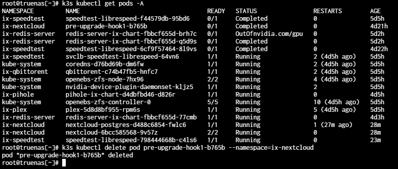

In my case I had a Pod lingering.
So in the truenas shell with root execute:
k3s kubectl get pods -A
identify you pre-upgrade-hook1 pod and go with
k3s kubectl delete pod <pod name> --namespace=ix-nextcloud

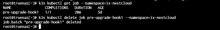

then locate the job with (we already know the name, just confirming it's there)
k3s kubectl get job --namespace=ix-nextcloud
and remove it
k3s kubectl delete job <job name> --namespace=ix-nextcloud
Make sure you use the namespace (this or another) otherwise it will use default and will not find anything.
Then proceed to upgrade the App and it should be ok.
