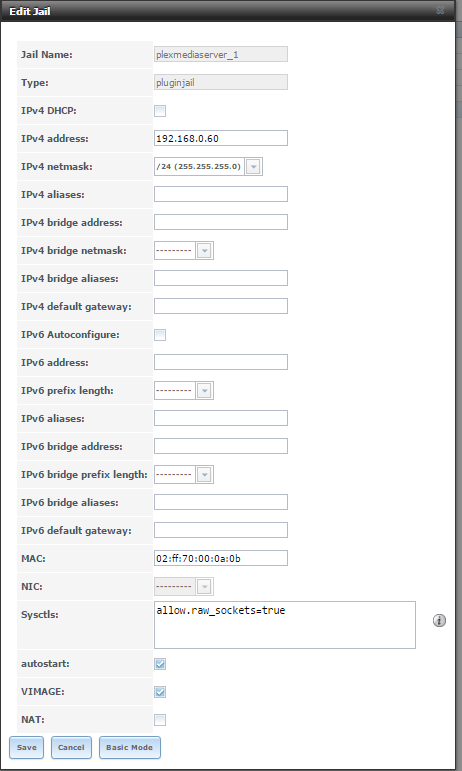

My Plex Server has been fine for months but today i upgraded to the Virgin Super Hub 3 and now its not accessible outside my network. All my other plugins are working fine. Not sure how to fix this.
My local IP changed when the new router was installed
uPnp is enabled on the router.
NAT is disabled on the jail.
Port 3400 forwarded in router to 192.168.0.60
http://IP:32400/Web works (http://canyouseeme.org/ also showing that 32400 is open)

PLEX > SERVER > Remote Access didn't used to have errors below Fully accessible and used to show the actual ip of the plex and of the public ip
Private Unknown IP Public Unknown IP Internet
When i click Disable Remote access or click manually specify port and click apply it just says "connecting..." for a lifetime.

Fixed it by making the Jail DHCP and then just reserving the IP in the router which then showed the local and public IP in plex settings. I'd still like help with the slowness of loading the installed plugin page so if any one can help i would appreciate it.

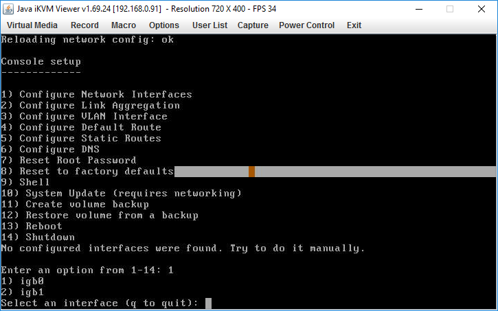

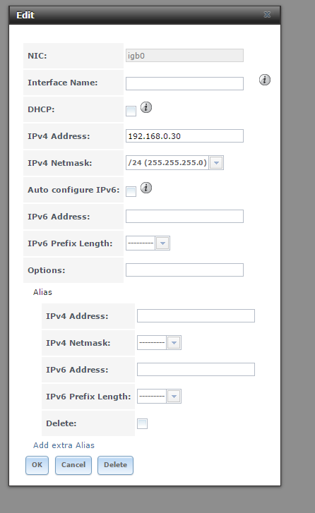

I noticed the FreeNAS wasn't getting updates or showing new plugins so i set the network interface to DHCP now i cant get into my freenas web UI please help.
It says no configured interfaces were found. try to do it manually from the KVM viewer.
update trying to set it back to the way i had it before:
I press 1 to configure,
select option 2 (igb1),
reset network config - N
Configure for DHCP - N
configure IPV4: Y
interface name: blank
ipv4 address: 192.168.0.30/24
Configure ipv6: n
it says its accessible at 192.168.0.30 but its not.
Edit: Panic attack over, managed to fix it by restarting the server / router and its now on DHCP.
