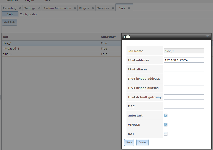

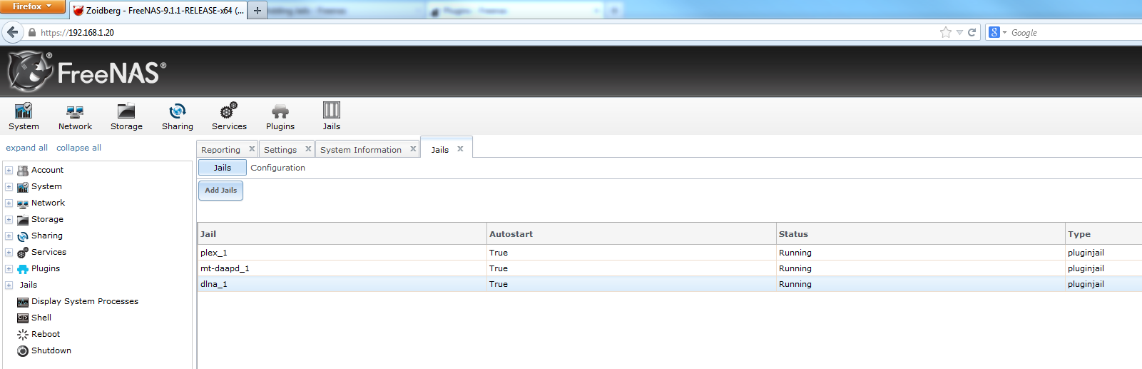

Hi what do you mean with "start your Jail"?
I did nothing but here the screenshot showes running...
Is this right...
And I also checked the Jail-IP but still nothing...

you have to check in plugins, if the plex service is started inside the jail. in freenas ui 1 icon left from the jail icon is the plugin icon
then go to 192.168.1.22:32400/manage

I can Ping the Plex Jail IP from the FreeNAS CLI.
[root@Zoidberg] ~# ping 192.168.1.22
PING 192.168.1.22 (192.168.1.22): 56 data bytes
64 bytes from 192.168.1.22: icmp_seq=0 ttl=64 time=0.024 ms
64 bytes from 192.168.1.22: icmp_seq=1 ttl=64 time=0.022 ms
but not from the other machinces in the network.
I executed this commands:
-Default Route is set.
But what exactly did you mean with: Ps. Dont forget about proper folder permissions for plex mount points/nullfs mounts
How can I do this and where?
With the GUI or CLI??
