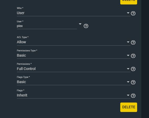

I have the same problem. Plex will not load any metadata.
I created an user "plex" with the correct id. Afterwards i was able to add the files to the plex library
But for now there will no metadata be loaded
i attachted the log files also. Would be nice if anyone with more skill will be able to help me out. I think it is a permission problem.
