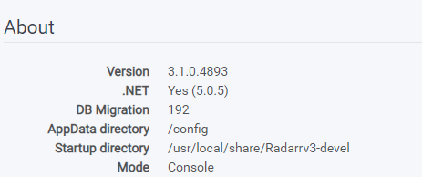

What version of dotNET Core is it using?
It should look something like that

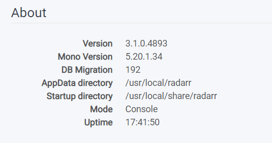

It´s not running .NET. It´s mono still:

ah! I see now. Radarr team did publish a Mono version of that.
As of right now there is no official pkg/port of the dotnet version. You can: ignore the message until the port maintainer migrates over, manually download and install the tarball, or use the experimental package.
