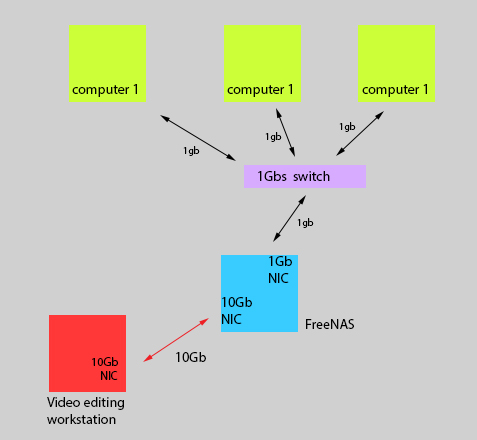

Basically I can't spend money on 10gb switch because I only need 1 of the machines connected by 10Gb.
Below is a quick doodle to explain what I want to achieve. My main workstation is used for 3D, video editing, after effects, nuke, etc. It would really benefit from 10 Gb connection. Other few computers are used for basic graphic design and 1GBs is enough.
Is it possible to setup freenas to act like a switch? Sorry I have zero FreeBSD experience, would really appreciate is someone can point me at right direction.

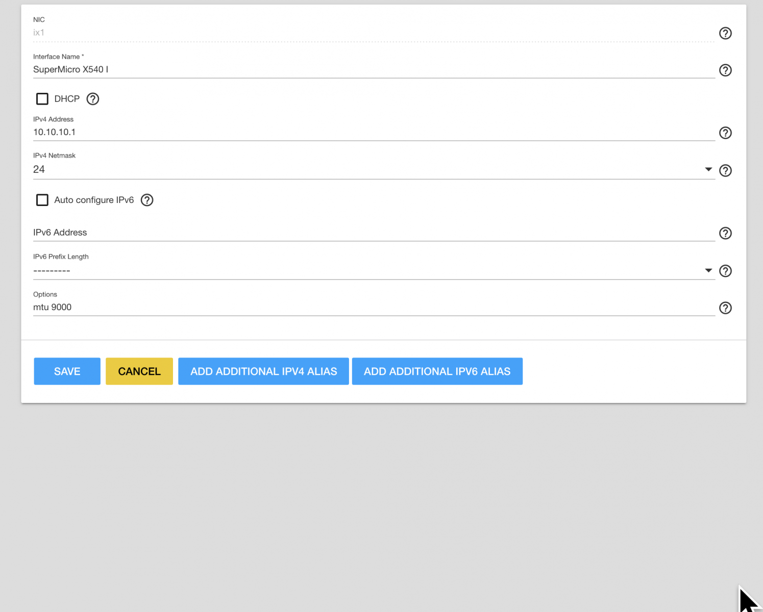

My connection goes as follow:
SuperMicro x540 on FreeNAS box >
Network > Interface >
IP Address: 10.10.10.1 (needs to be different from your default connection to your router)
Subnet: 24
Options: mtu 9000

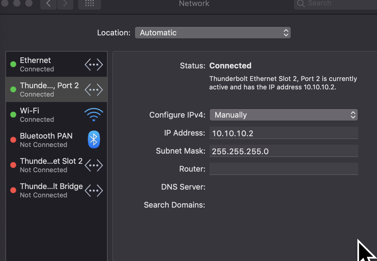

On my iMac
Sonnet Presto Dual Install on Sonnet Echo Express SE I >
Connect to iMac via Thunderbolt 3 to Thunderbolt 2 adapter >
System Preference > Network > ( make sure driver is install and find the Thunderbolt connection)
Select connection >
Configure IPv4: Manually
IP Address: 10.10.10.2
Subnet Mask: 255.255.255.0 > Apply!!!

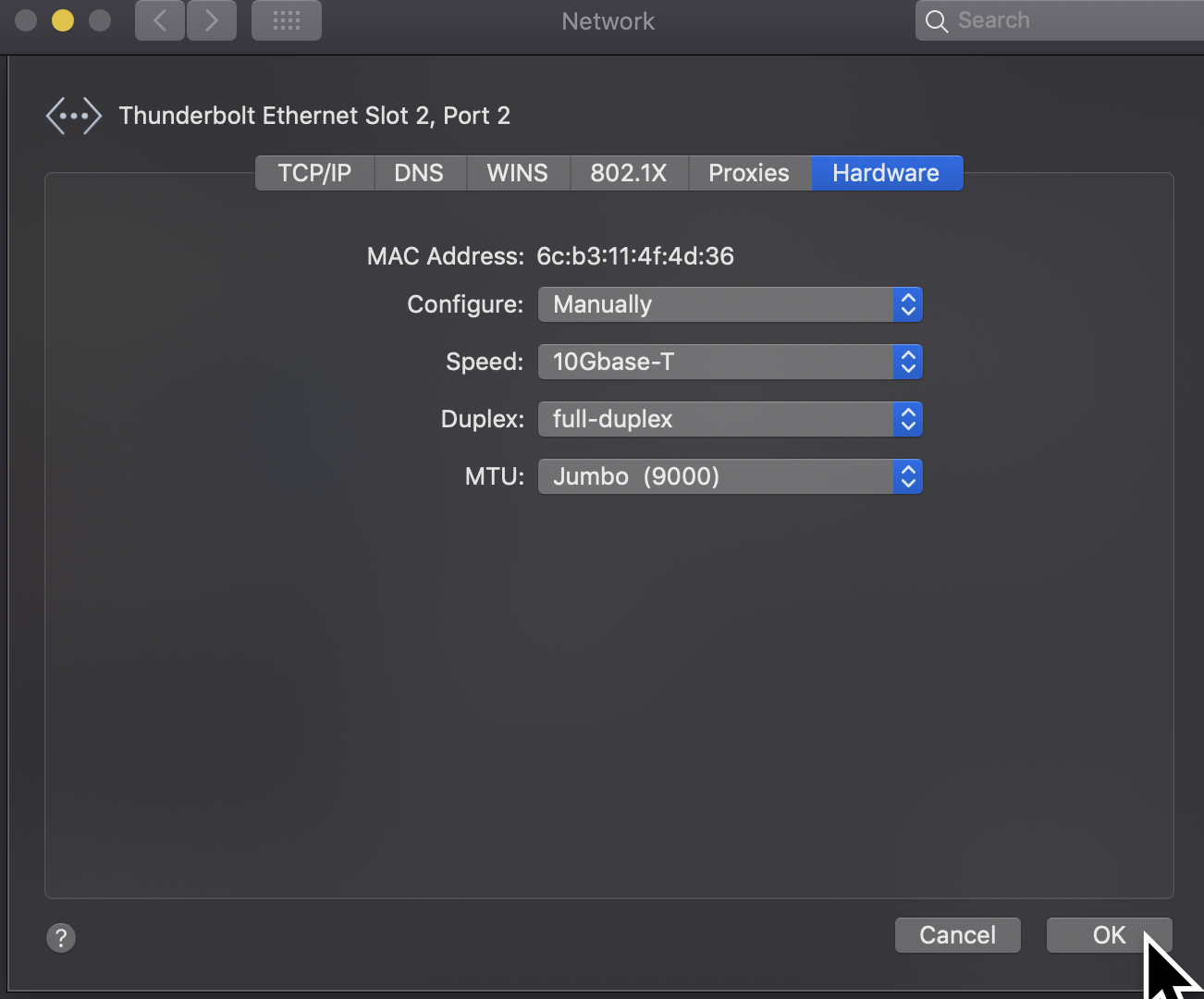

With Thunderbolt connection selected >
Advance > Hardware >
Configure: Manually
Speed: 10GB-T
Duplex: full-duplex
MTU: Jumbo (900) > ok > Apply!!!

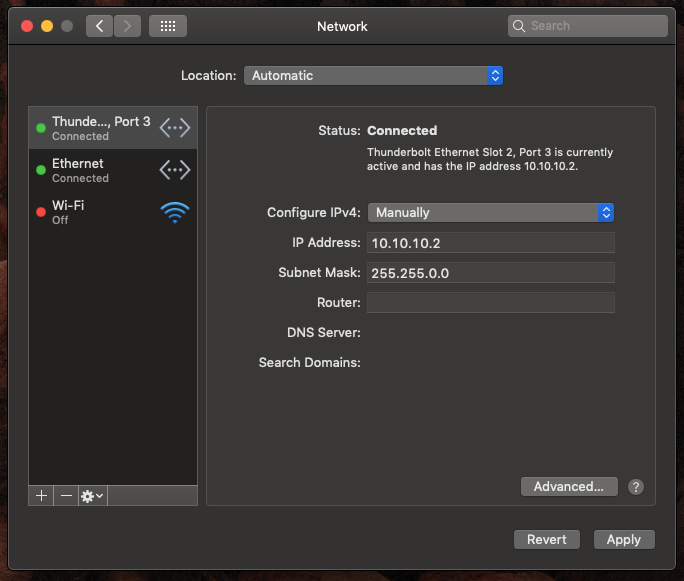

Hi @VolumeTank everything works likes you said. I ran into a minor issue. So prior to making this work I had the FreeNAS hooked up onto a 1gbe network switch which serves to 10 computers in the office also providing internet. The issue now is that on the single computer that now has a 10gbe connection straight to the FreeNAS, also has a 1gbe connection to the switch. So now I have to manually activate the 10gbe connection in mac os X network panel each time I need to mount the FreeNAS shared drive. If not then my computer picks the 1gbe connection. If I disconnect the 1gbe connection then I do not have internet. Hope that makes sense. I am trying to figure out a solution. in the image below is the network panel. "ethernet" is the 1gbe connection to the FreeNAS and internet. The "thunderbolt" is the 10gbe connection to the FreeNAS only.
Remember there are 2 different IP’s on your Mac finder sidebar on network will show the 1gbe connection. The 10gbe connection, you would have to do that manually. If you connected the 1gbe manually juste delete that one. You don’t need to have both connected, you could if you want. Also to avoid that problem once you are connected via 10gbe go to settings and add the network drive as a login startup item.
I also, Isee that your subnet is set to 255.255.0.0 if that’s the one you going to use, make sure you use that on frenas for the 10gbe card as well.

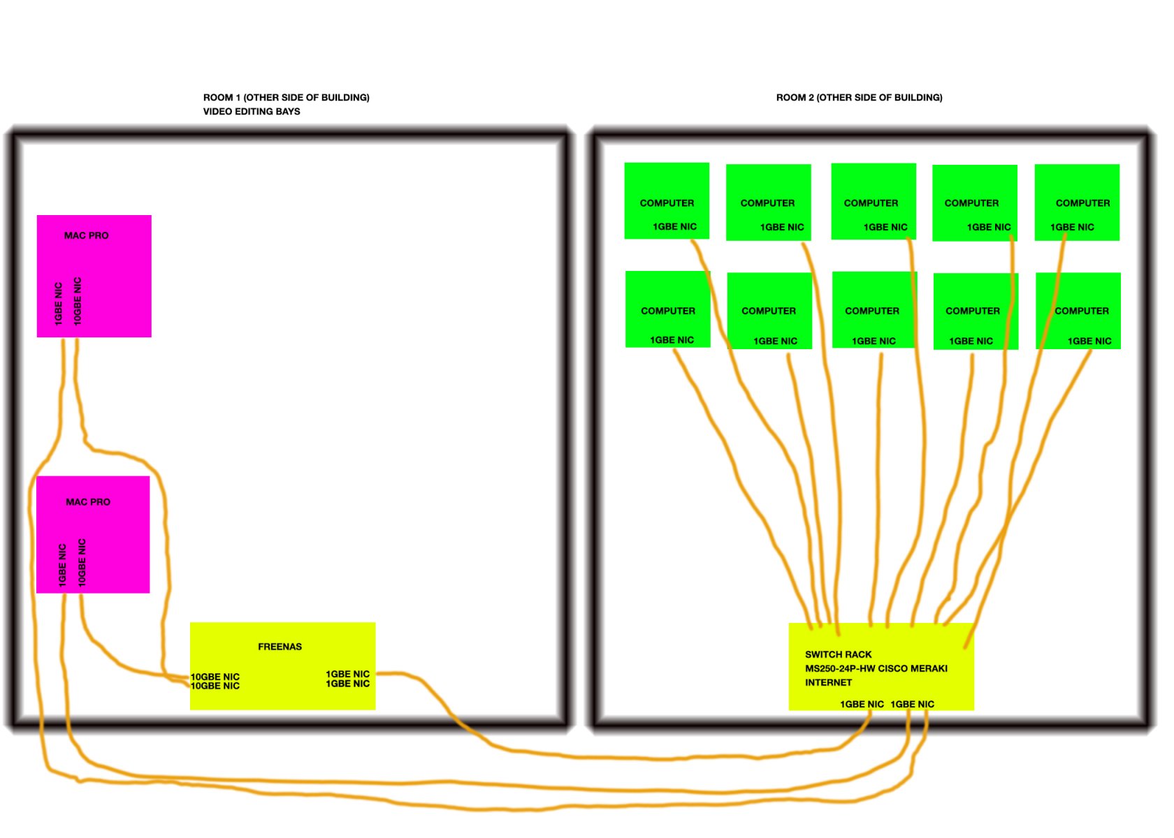

If for any reason I unmount the shared drive over the 10gbe connection and mount it again the finder will choose to mount over the 1gbe connection. (i ran speed tests to confirm) So everytime I want to mount the shared drive over 10gbe I have to go to the network panel and turn off the 1gbe network, then mount over 10gbe and then turn on 1gbe so I can have internet access and access to other computers on the network. Its kinda of annoying and wish I didnt have to do that. below I made a diagram of my setup. IF I cut off the 1gbe connection then I loose internet and access to other computers in the building. @Constantin we have a switch with 4 sfp+ ports but we are unable to run cables to the other side of the building or purchase sfp+ to rj45 adapters.

Base on your diagram is the same way mines connected. That must be something on the mac's pro or something. Can you share a a screen shot from your freenas interface set up on the GUI. Also you have 2 mac's pro? If so remember that every port would need its own IP.
In your case I would setup like this:
FreeNAS 10Gbe 1 -> 10.10.10.1
Mac Pro 1 -> 10.10.10.2
FreeNAS 10Gbe 2 -> 25.25.25.1
Mac Pro 2 -> 25.25.25.1
The 10Gbe NIC's should not collide with the NIC's 1Gbe because is not connected to the network. I would share a screen shot of mine.
